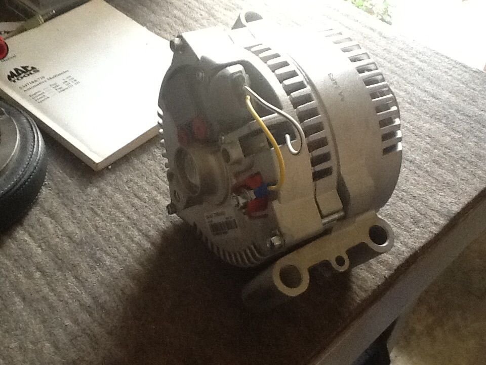

Freshly assembled with all new parts and tested at 180 amps. Only problem I have is the self exciting harness. They told me to just hook up the battery wire and tie back my small connector. How is that going to affect my instrument panel and pcm? This regulator won't work with my harness but it's supposed to be better than the one that will. Some of you guys who know alternators well have any thoughts on this? I don't have a problem changing the pigtail if the other regulator is really what I need. Just waiting for the truck to cool a little before I install it..

Well, after some hassle (wrong pully) got it installed. Expected issues with ScanGauge and got them but it was different than I expected. The video is the first crank with it installed, I wanted to catch it if something smoked -lol. This is also the FIRST video I've ever posted here. Please ignore my babbling. I type a lot more than I talk, unless I been drinking . Anyway the question I guess is, do I need to swap this regulator to one that is supposedly weaker but will plug into my truck (with a pigtail change) or stick with what I have now?

Use a 6g to 3g conversion harness.
Or do as they suggested and shunt the yellow wire back to the charging post. The red/green of the 3G needs to tie in with the Pin 1 wire on the 6G.
Pin 1 is the alternator excite wire that also loops back to the dash cluster.

They way they prepped it for me they have the yellow wire going to the bat post and a white/black stripe looping around to another plug on the alt. I guess the snipped off the red/green wire at the plug... I didn't unplug the connector to see if all three pins are used on that regulator.
Does it make sense that my actual battery voltage is 14.14 and the ScanGauge says 13.6 now? How can I not have a battery light when the sense wire isn't connected to anything? I don't know if you watched the video but at first start voltages stayed 12.2 ish for a long time then once I revved the truck the first time it went up and stayed up. Is that maybe related to using the larger pulley?

Look to see if the Pin 1 post is still there.
Seems they are are trying to make the 3G into 1 wire hook-up which doesn't work very well and the reason why you had to rev it to get it to charge. Exactly the same as a 1-Wire GM alternator works.
Not sure on the battery light situation.

Thanks Josh. Gotta quit and crash for the night. Work tomorrow then out of town for a day or two (Hotlanta Ga ), may be the weekend before I can get back to it...I can see the batteries are charging well once you rev it the first time after starting (yup just like you said it's going to be that way after every start it looks like) and I could maybe monitor FICM vehicle power or another PID to get a more accurate read on the battery voltage on the ScanGauge but I'm not happy with the set-up like it is. I think I'll modify it like you suggested and see how it acts.
