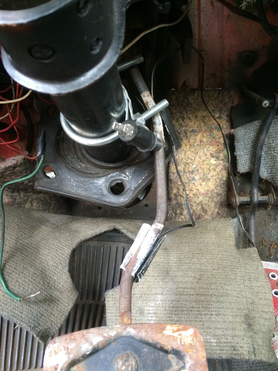

Before I remove it, is this normally jow the brake light switch should be? I don't recall seeing this and it is obviously rigged up this way and not original. Not that anything is original on this truck...

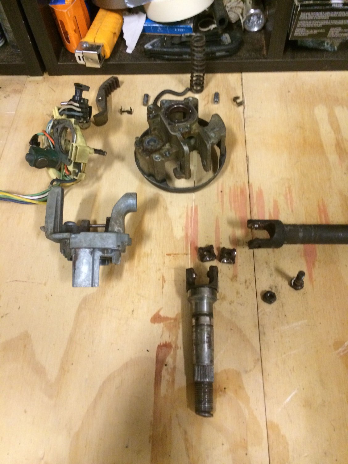

Disassembly complete.
PROSTOCK, I guess these little square things are the bushings you made? Mine are indeed quite worn.
I assume these are not available me anywhere, but maybe ND will prove me wrong.
I could replace my and bolt and apply some loctite and that would help but I think these being be replaced would be the best.

Yes sir, that appears to be a brake light switch. I saw the clamp and wondered what it was for. With that pedal assembly I am not sure how to reattach it. I posted a photo of my setup about a week ago but can't find it this morning.

Thanks John and yankbs. That picture is helpful. I will have to get and under there and see if I can rearrange that.
Anyone have any ideas on those worn bushings? I actually found the ball bearings as they are ubiquitous and can be found lots of places. I guess I could ask a machine shop to make me a pair. Should be simple.

Well, the issue is resolved. Cleaned up the joint, put the not on with some Lottie and tightened the heck out of it. Didn't put it all back together put put the shaft back in and the slop is gone.
The bearings in the column are shot so will replace while I have it in pieces. To the rest of the column out and will clean it up and paint it before putting it back.
