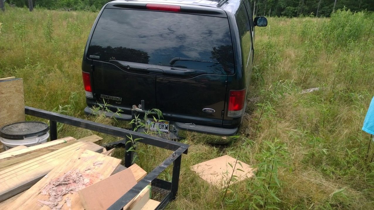

I was driving a load of wood on a little 5x10 trailer through what I thought was a dry pasture. I found the only hole in the place and quickly made it bigger as my trailer jack plowed in and set root and my truck frame sat down on the ground. I had the back of the truck full of junk also as we were planning to move to Texas.That was also the day i realized I couldn't trust my auto hubs because by the time I locked them by hand, it was too late. I had to get a shovel and dig under the trailer tounge/hitch to relieve enough pressure to unhook it, due to all the weight sitting on the ground, that was after unloading a thousand pounds of wood where I didnt want it. Then it took a tractor and another 4x4 pulling in 4low at the same time to get free and I was just stuck at the rear axle and only one wheel was really in mud. I cant even imagine pulling one of these that was really all four wheels stuck in some gumbo with a trailer behind it. I would get the biggest winch I could afford/fit if I had to trailer through nasty stuff on purpose.
