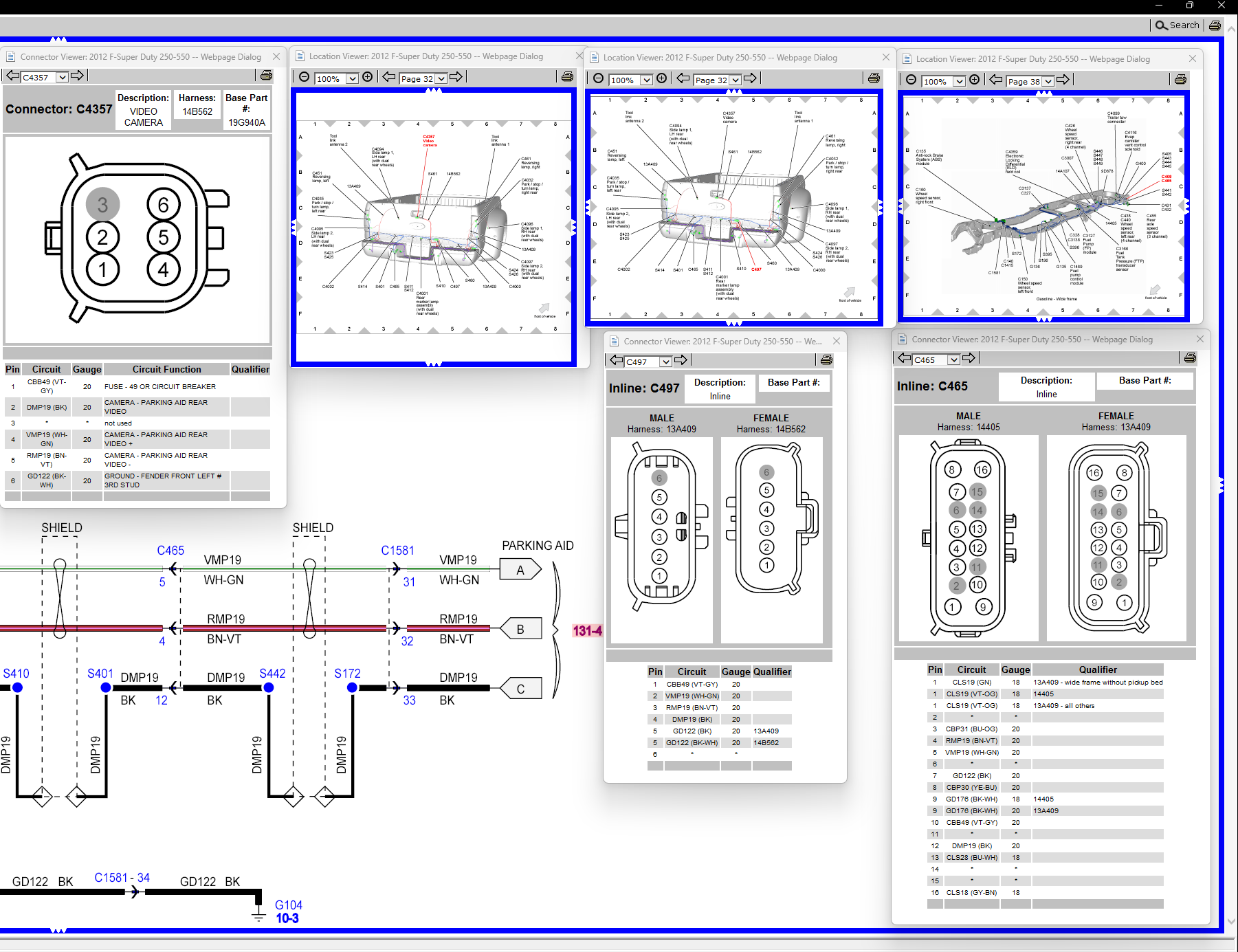

I need to know what wires to tap into to wire the factory camera to my new headunit any help would be greatly appreciated !! or what I need to do to get it to work its a 2012 f350

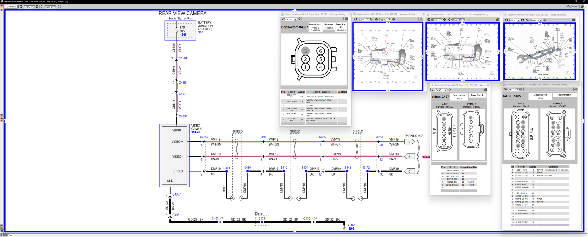

this is the hard to find 2012 f350 camera wire diagram with connectors, pinouts, and locations.
do whatever you want now. no need for a $200 cable. you are welcome my friends.
