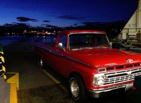

Hey guys,
I'm considering replacing the engine in my 1966 F-100 and I thought I would ask the forum for some advice on some replacement options. She currently has a 300 I6 in her that has been running very reliably, but the coolant system seems to be rotted out (judging from what I've seen replacing thermostats, etc) and she runs very hot when she has a load in the back, especially on warm days. The 300 I6 seems to be a (almost) bullet proof engine that gets decent gas mileage and will tow a little bit, but there must be some other bolt on options out there. Suggestions? And what are your reasons for the suggestion?
