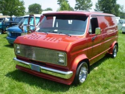

So you mean having wheels like this -
Both wider and taller in the rear. Hmm... that would be purely for looks since the van is designed for the same size wheels front and back. A '78 van wouldn't have ABS or traction control to confound, though. Having different diameters messes up carrying a spare since you'd have to carry two or drive lopsided to a tire shop. Custom vans can look sharp with the same size wheels front and rear. At least Mr. T thinks so -
You can have the rear sit higher and/or the front sit lower for the impression that the rear wheels are taller. It's difficult for the rear wheels to sit much wider than the front since the front have to stick out more to clear the the frame when steering. Also, rear wheel protrusion is limited when you have a sliding door.

Yeah I like the fat wide tires, what size tires are those? They also look nice the same size. How would it look if they're the same size but 8" wide in the front and 10" in the back? Sorry for being so difficult.

Your van must have 8 lug wheels on it. The ones above are all 5 lug with 15 inch wheels.
If you want that look I would search for some 16" wheels that fit your van. Probably 8-10" wide and then Look for some tires that are 265, 275, 285 with with probably a 50-60 sidewall.
