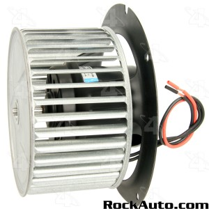

I think I understand what your talking about - Does your fan/blower look like this??
That's from Rockauto, FOUR SEASONS Part # 35514 $39.79
Fits 1977-1991 E's
What the fan they sold you, might be for the 1992+.

That is the picture of my fan motor and wheel.But the blades are pointed in the wrong direction.With that fan running in the van it is pulling air from the vents on top of the dash downward.You can run it in the other direction and the same results.You look at the duct work and see which way it needs to go.I bought a fan from autozone and it was a inch smaller than the one I had.The fins were in the right direction.Had to drill out the fan shaft to 5/16s.Since the fan had a recessed collar I had to shim the round fan cover out out so the fan would not rub the cover.I hate to jury rig something to get it to work.I found a fan that went in the right direction but the hole was 3/8s instead of 5/16s,but did not know if the made a shaft shim.You never know.Was going to post pics of what my fan looks like but did not know what to do.Thanks for your input.Thats more than what I got from the auto stores.Greyhound
