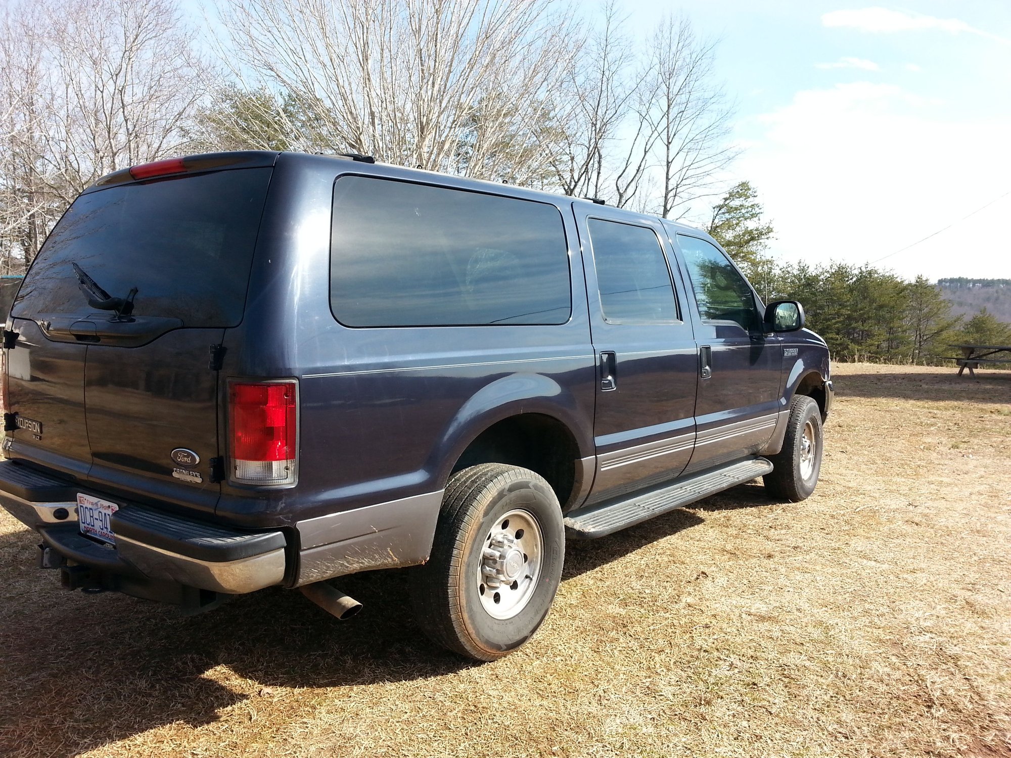

So here's my beast (it's a little dirty :/)! It's a 2001 v10 gas with 164xxx miles and tan interior. It's got new belts, new alternator, and new torque converter. I'm looking at upgrading it so it can handle Colorado Rockies weather when I move there in the fall. Needs some body work, and a new paint job. But other than that, here's what I wanna do to it:
-full length luggage rack (w/ fog lights)
-update the grill
-bull bar
-37" humvee tires
-3" lift
Need some help finding the right hardware! What racks and bars will work with my ex? Would love to see some examples. Also, I need to know whether or not I'll need to jack it up to put 37's on it. All opinions are welcome!
