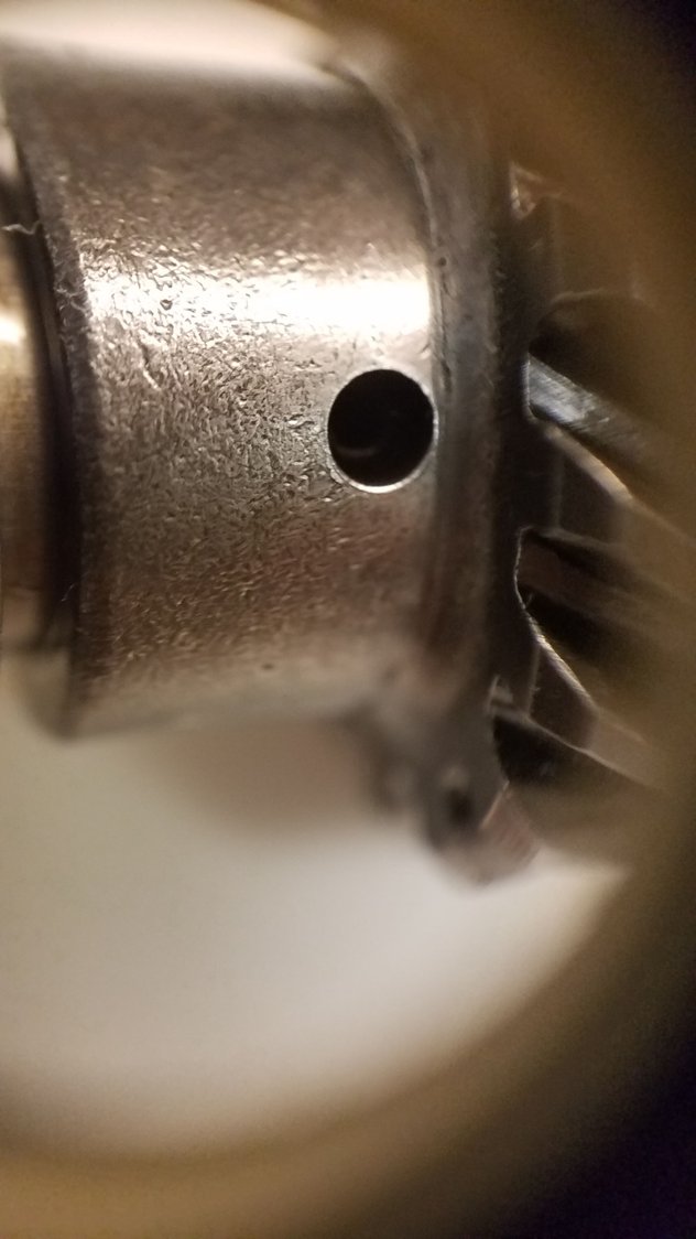

I know it has been awhile, but this issue is driving me completely bonkers. Did the steel gear work??
My OE distributor (95 F150 5.8l Windsor, 11/94 build date) has the same part number as yours but I am unable to find any source that lists a distributor for this application that has a steel distributor gear. I can find steel gears for a 93 on RockAuto (WORLD POWER SYSTEMS DST2700 {#F4TE12127AA, F4TZ12127A}) which supposedly matches the OE p/n.
I also just got off the phone with the local Ford dealer who, while unable to provide a distributor, did tell me that 95 F-150 5.8L (non-Lightning) only shows roller cams so a steel gear should be used. He also said that you can tell them apart because the reduced diameter on the gear where the roll pin is located will not have any machine marks on it if it is cast iron and will be fully machined if steel. Great except the gear on my my OE distributor appears to be cast! (see attachment).
My next step is to pull the valve cover and rocker and measure the length of the push rod, which I understand will be about 7.5" for a roller and 8.1" for a flat tappet. While I hate to go to that trouble I believe it should settle the issue. However, if it is a roller cam (as I suspect) then can anyone explain why it appears no one sells a steel gear distributor for that application? Has something changed in the metallurgy they use that allows a cast gear with a roller cam?
According to my wife I have burned about three full days, on and off again, trying to resolve this, so I gratefully appreciate any info that helps resolve the question.

Spark test it. Use a small grinder and and touch it on the shank if it is steel it will make a lot of sparks and they will be very bright gold to nearly white in color. If it is cast there will be very few sparks and what you do get will be dull and very reddish.

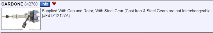

just my $0.02 maybe its like our ICM(grey/black) they dont know, have wrong part #, if you put in any year except 96 you only get cast iron choice, put in 96 5.8l see pic
this is a choice only if 96 5.8l put in at Rock Auto

Hmmm - that is interesting. That same p/n is also shown as the distro for Lightning versions in 1993, which I thought were flat tappet (see https://www.hemmings.com/blog/articl...ord-lightning/)
. Note both the top one (the World Power Systems) and the bottom one (Cardone) show both my OE p/n and the one you found for the 96. Do the flat tappet Lightning cams have steel gears??

I dont believe I've ever heard they did, but theres one guy on here with thread going says his 93? 94? 95?(dont remember) says his cam is flat tappet, then posted pic of intake valley, and you could see spider/dog bones in pic? so never say never...maybe, but, when my pip failed a couple years back, I decided to get JY with all the horror stories! getting from big parts stores, when I pulled my old dizzy, it had a yellow paint mark on it, and so did the 94 I got from JY? hmmm, my old bosses 91 didnt have a paint mark? may just be coincidence?
