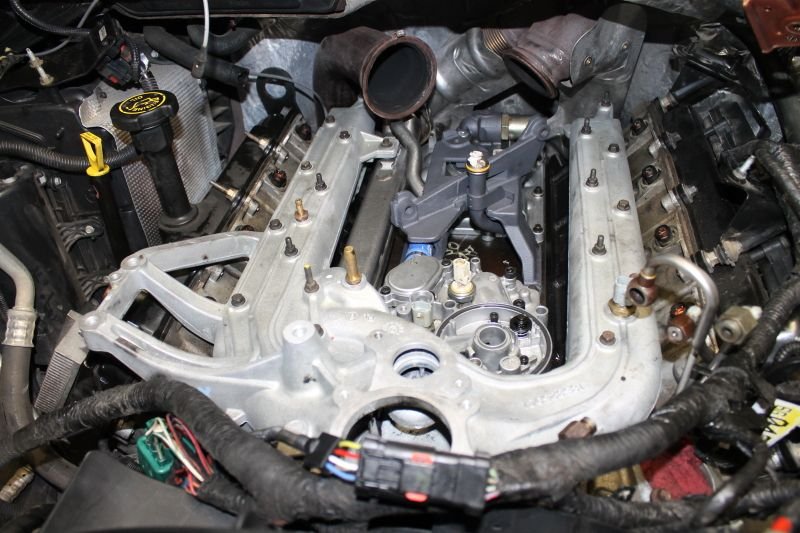

Here is a picture of the square egr cooler. Visible just under the passenger side rail of the intake manifold. On a fully assembled engine you can get a look at it just beside and below the turbo, if you're at the right angle. It's easy to see it flat on the top. The early round cooler will be...round. I believe the mid year design changes included both the square cooler and the ICP sensor being relocated to the passenger side valve cover. If you have a roundish sensor with three wires on the valve cover just behind the alternator it should be a square cooler. If there's no sensor there it should have a round cooler.
