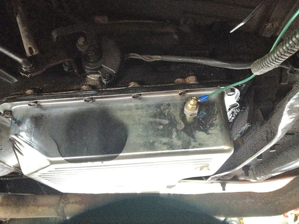

I've read about everything on transmission temp gauges on this site and what they should read depending upon where they are placed is a bit confusing - Where exactly in this new bigger pan did you locate the temperature probe or sender?
That is a long grade you are climbing- I imagine a lot of switchbacks- what speed are you driving up it and what gears? Point being not a lot of airflow through the auxiliary cooler at low speeds and I don't think the converter locks up until 3rd gear at 35+ mph so the transmission will probably get warmer at lower speeds and stop and go driving - depends then upon the fan mostly.
Last thing which I'll get to later is the auxiliary cooler itself- and how it is hooked up.
Also, how far is the exhaust pipe from the location of the sender? I had a full size Cherokee- rugged mountain use carrying weight- the exhaust pipe from the manifold got bent and dented and it was very very close to the transmission and pan contributing to higher transmission temps. Just something to be aware of because that pipe gets very hot!
I made some pics today:
The sender is in the upper back. I was careful not to have it to close to the exhaust, same is for the wire going to the gauge. I's still aiming to get me another gauge, don't trust this one.

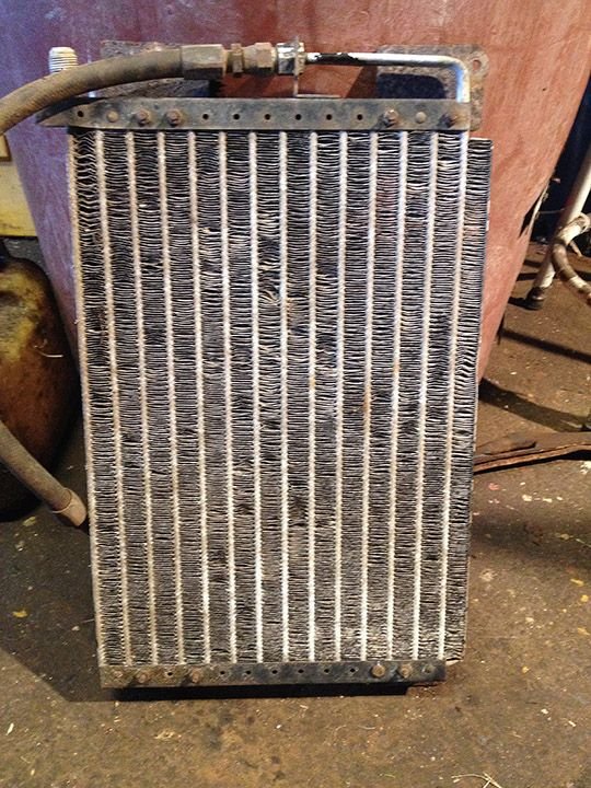

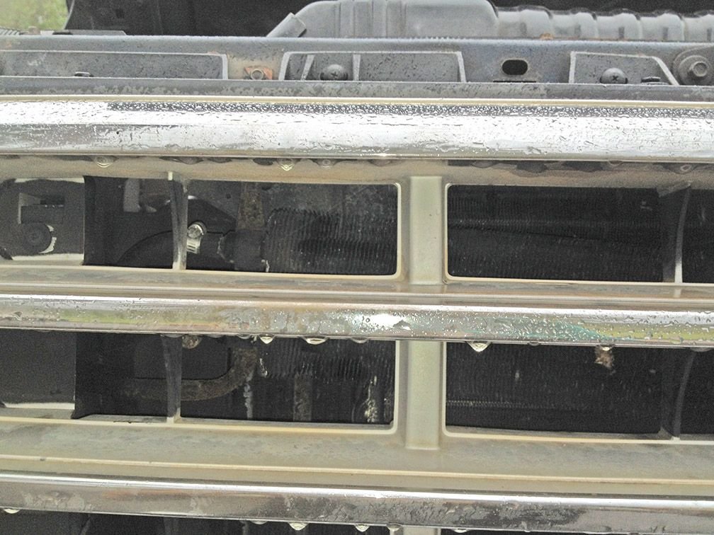

I also looked at my cooler situation: There is a stock cooler and then the line goes to the auxiliary
cooler, which looks like this:
The picture is not so good, I hope you can see it; in my opinion the auxiliary cooler is quiet small. So this might add up to a hot tranny. I was thinking to swap it for something bigger. I have a cooler which was used for a AC in a tractor and is just sitting around; it's a lot bigger and sure would help.
Is that a good idea or better to get something different?

That's the original auxiliary cooler that came with the truck from the Ford factory, at least on trucks with the 'Tow Package' (Trailer wiring harness- hitch).
It looks identical to the one I removed and replaced with a much better one. Mine was tube and fin, 4 inches high by 11-3/4 inches long. It had been leaking and the lines had been cut and plugged with bolts- the original lines routed back through the fittings on the radiator.
It had leaked fluid into the copper cooling fins of the radiator which then filled up solid with dirt and it looks like old dry grease and dirt packed into the fins. The copper fins are very old and very fragile on a 28 year old radiator - too fragile to try to pick the dried oil/dirt out without destroying the fins so I just left it. It's only an area of about 3 inches by 5 inches and that is a big and heavy radiator. The inside of the radiator is still very good (from what I can see) Regardless, a cooler leak or leak from the old hoses is something you want to avoid.
This cooler may have been fine and quite adequate when everything in the truck was new but I wouldn't expect it to be doing so well now after 27 years.

Personally, I would be hesitant to use the A/C condenser coil from the tractor, mainly because I don't know how much restriction it would have to the rate of flow from your C-6. The A/C system I think would be under considerably more pressure and less flow rate as from there it goes through an expansion valve.
