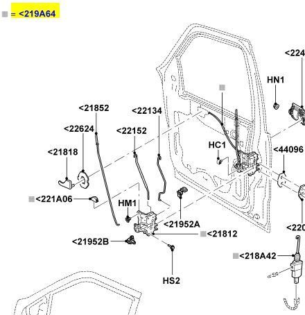

Ford Parts shows the latch assembly "with clip" & "without clip". Do you guys know what that means. How do I know if I need a "clip". The with clip kits are a lot higher. They also include some cable.

no clips, no cable
My OEM replacement latch had no clips or cable.
The Ford Parts dwg shows the parts in the "clips/cable" version. I didn't need them. Look for the gray square block next to the (assembly) parts in the snapshot below.
Reference:
2004 Exped XLT Sport 4x4
Ford Latch, driver's door, was PN 6L1Z-1621813-B, $ 47.50 Dealer List, $ 38.00 Net, May 2012.
Good luck.
