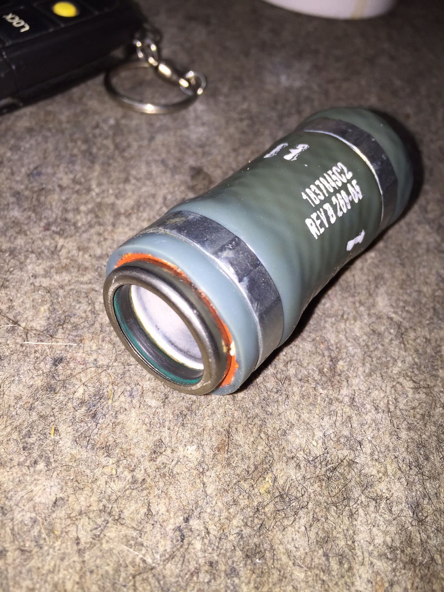

Probably not going to help much. There is a metal ring inside the hose that's not going to compress much. Below is a pic of the back end of one I happened to have on the bench. If it happened to be leaking from where the rubber meets the ring it might help, but usuially its leaking from where the o-ring (inside) meets the metal tube.
