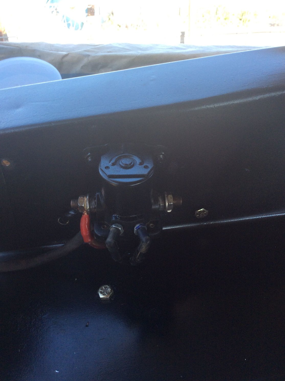

That's some funky looking wire lug terminals on your solenoid next to the horn relay.
That's one of the type of things that can cause it not to start sooner or later form over heating..
Orich
Orich
I didn't really see much difference in stoping at the solenoid or going to the battery, plus I have a #4 cable going to the battery.

Hard to tell from photo tho it looks like a lot of daylight in that connection. Plenty of current, maybe 250 amps goes through that.
That was my thought when I first saw it. People need to learn to crimp proper ends on wires.
I haven't searched for a thread regarding wiring, such as proper ends to use, using butt-connectors, when to solder, when to shrink wrap.
Maybe someone who knows electrical can do a tutorial on wires. Different gauge wire and how to splice, yaddaa yaddaa.

My bad, it was loose when I took the original pic.
