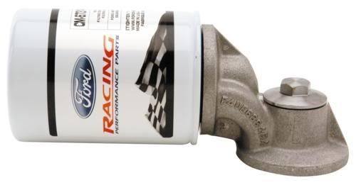

Now I'm just trying to track down a Ford racing oil filter adapter so I can ditch the oil cooler at the same time... Does the dealership stock ford Racing??? If I order online it will take forever and I need it fast

I'm having some trouble finding any Ford Racing remote oil kits that aren't for the Coyote 5.0L, although there are some 90* adaptors for the 460.
See:
Someone else may have better luck.
Is this on your 460? You may have better luck at an Oreillys/NAPA/Autozone.
Here's a list at O'Reillys:
List: Search for 'remote oil filter' | O'Reilly Auto Parts
If it's for the 460 in your signature:
List: Search for 'oil filter relocation kit' | O'Reilly Auto Parts

And yes its on my 460. I can get the ford racing adapter on amazon/ebay but will take too long. I was gonna order it way back when I got the block insert from Ford, but nooooooo, I thought I'd wait... Shoulda bought it then...
