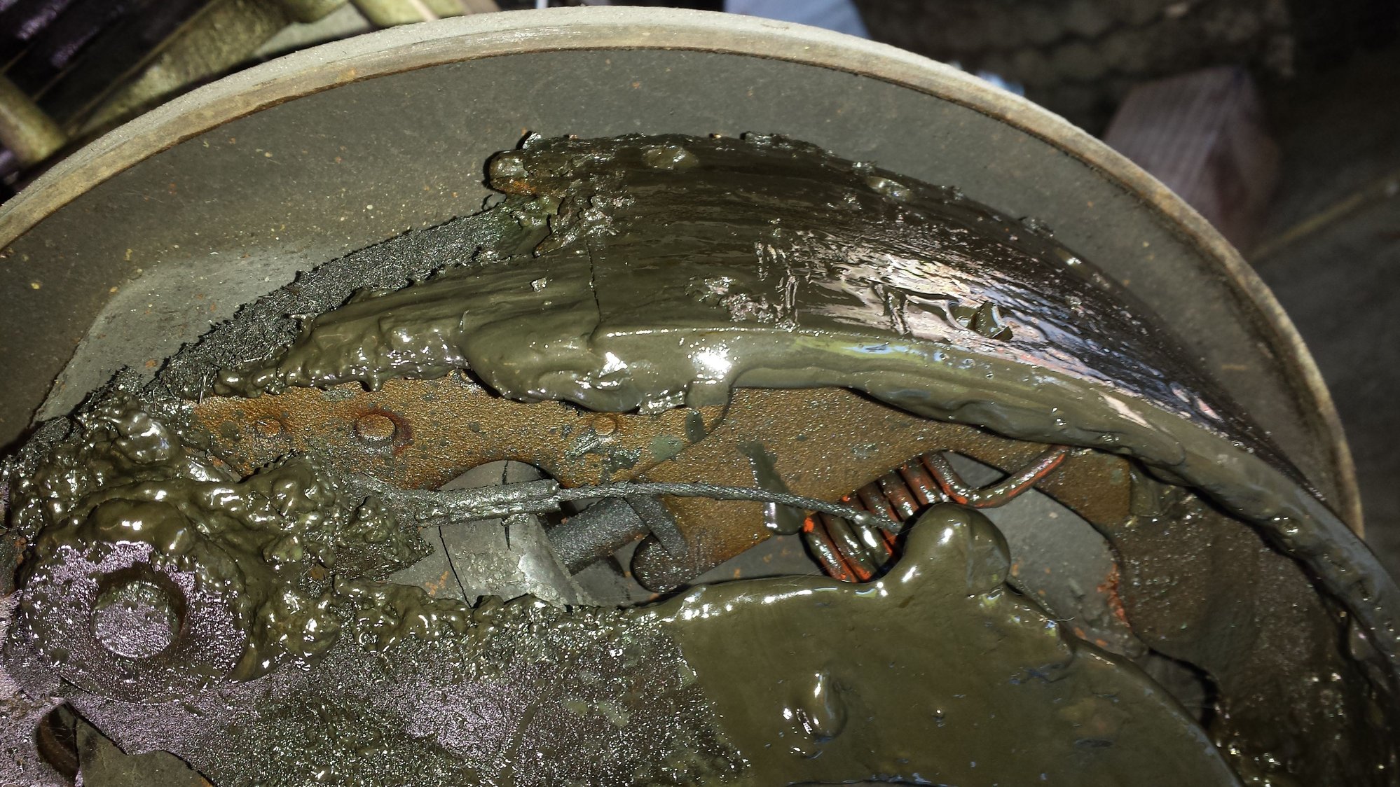

Here's what mine looked like when I took the drum off so I basically replaced everything except the axle shaft and hub:
And after:

9thPony- OMG! what a mess I guess you were wondering why it wasn't stopping good enough. Nice job on the rebuild!
