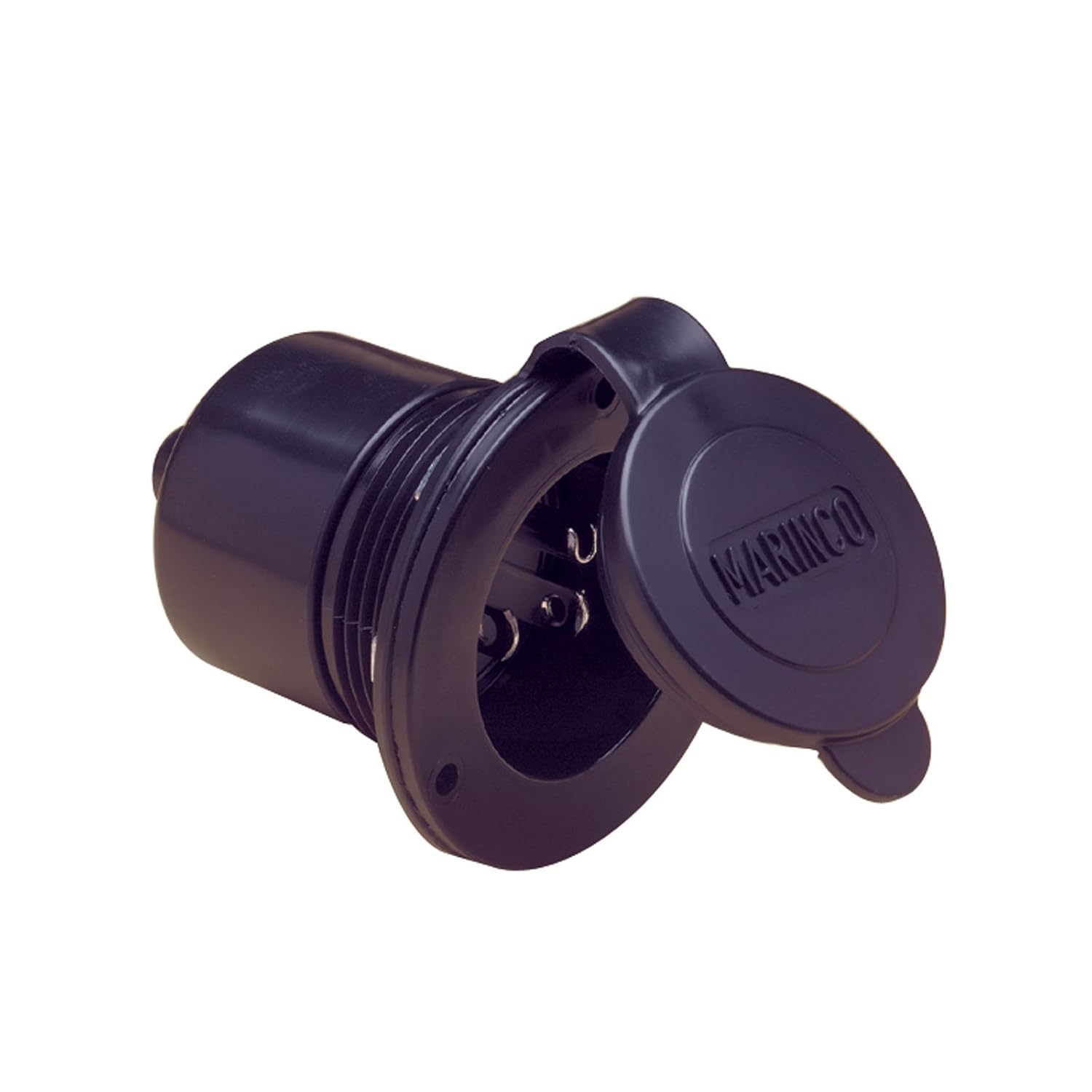

Some guys are getting fancy and installing a marine covered receptacle in the bumper.
When my plug goes bad, I'm probably going to install one of these in the front and rear bumpers.
we use a similar setup on our big rigs they work well at keeping road grime out..
