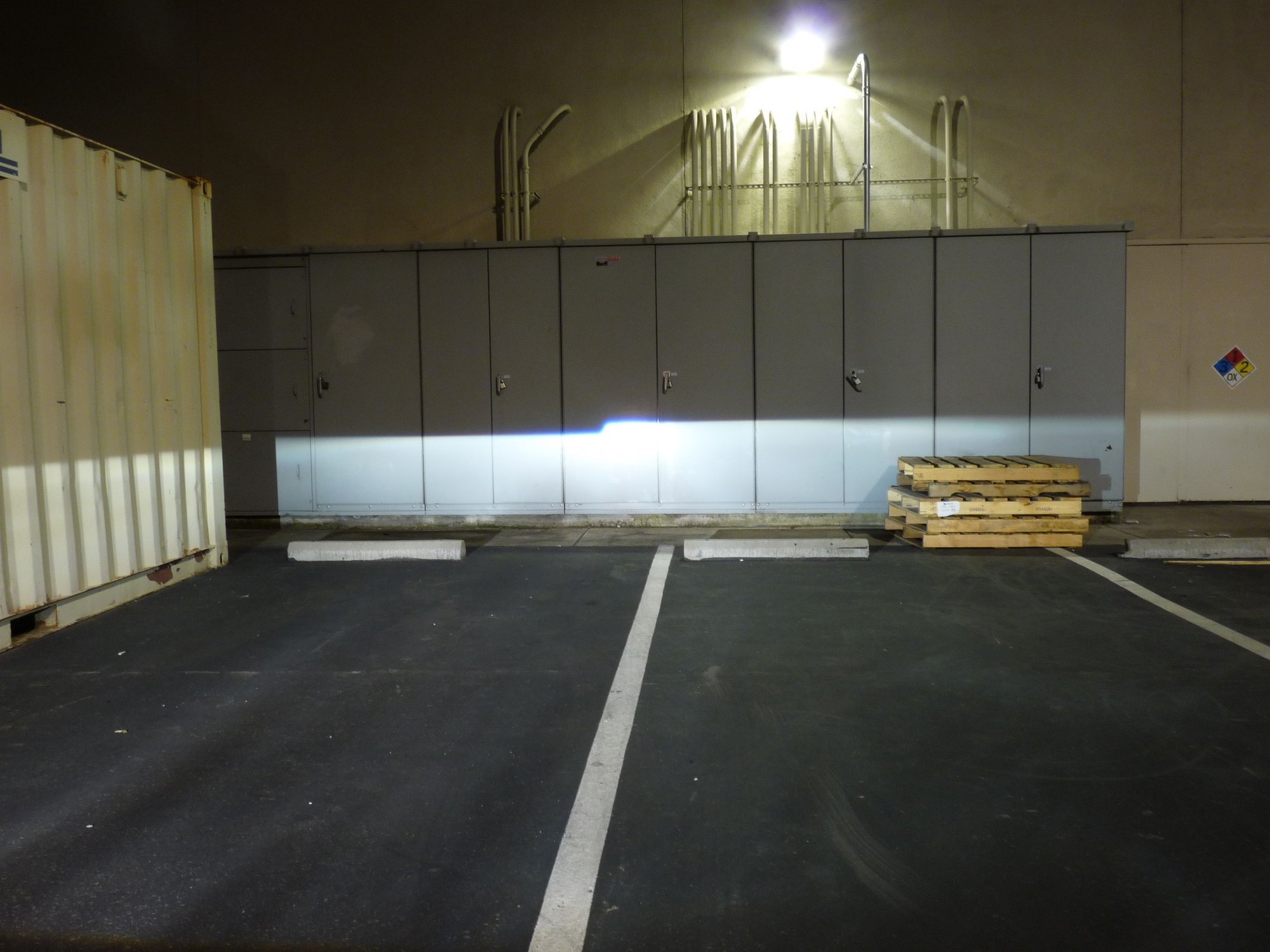

I just installed my HID projector retrofit last night with great results. It took a little time lining things up, but I am pretty happy now.
Black Flame Customs did an awesome job with them.

Very nice! It looks like the output is greatly improved. Are those night shots with your light bar on or just headlights? I am very interested to hear about the difference in nighttime visibility and if other drivers flash you more or less now. I have factories and I get flashed all the time with my lows, but I'm lifted and haven't adjusted them yet.
Those night shots are the headlights only. The nighttime visibility is significantly improved over stock. I am extremely happy with the results. How high are you lifted? I am at the stock height, and wouldn't get flashed at all. I have yet to get flashed with the HID projectors yet. I aimed them a little bit low, so I have room when I am towing as to not bother other drivers. The great thing about the projectors is the clean cut off line. There is no glare from a reflector. As long as you properly aim them, I think they would be fine.

Here is another pic of the cutoff. Laser sharp!
