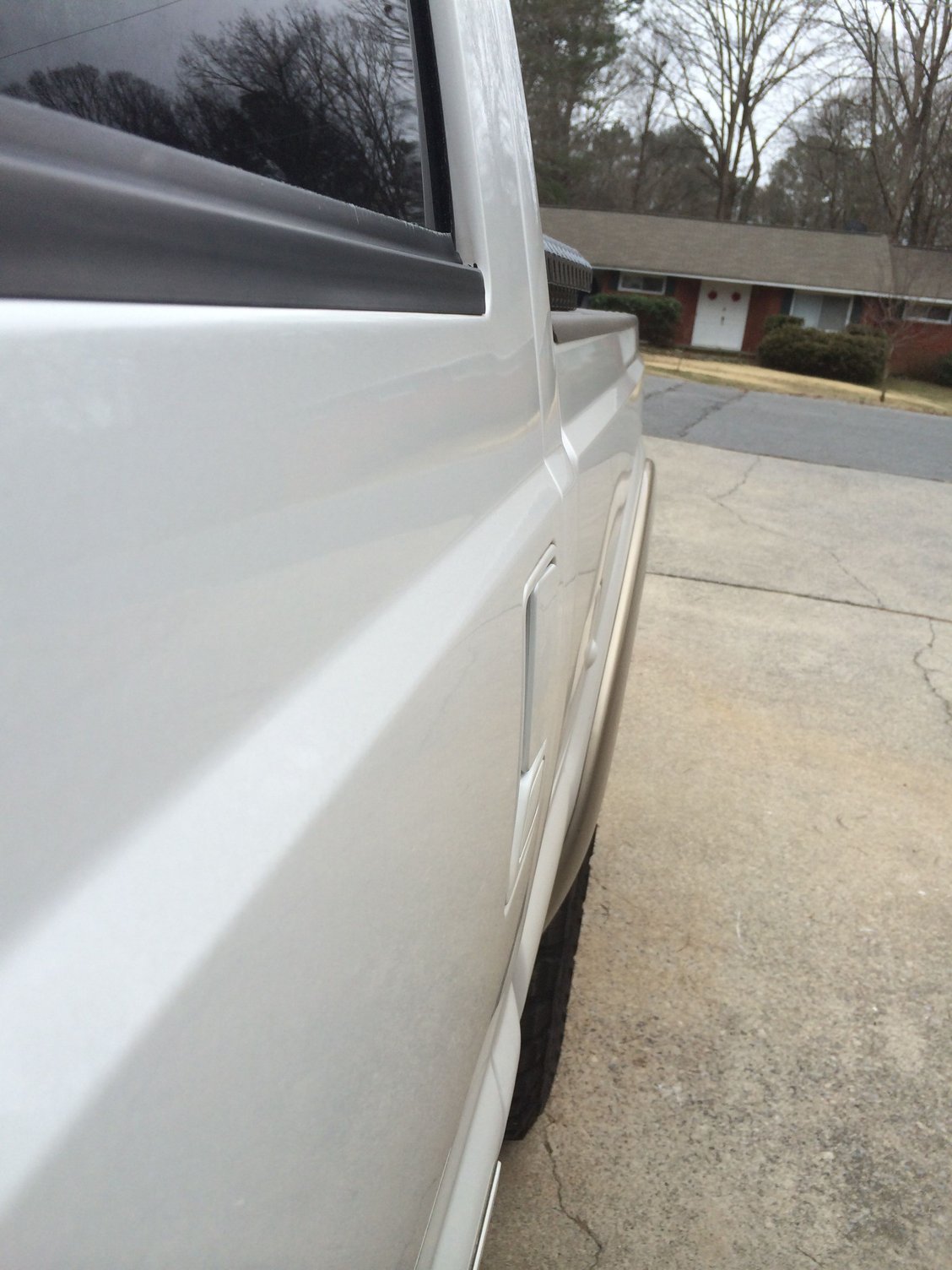

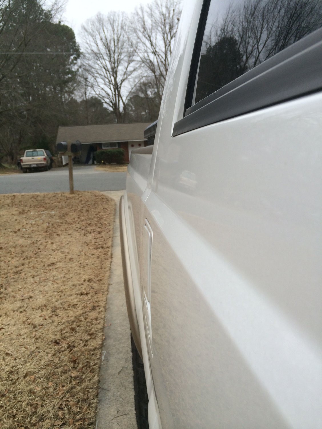

Is your Bed Lined Up?
2015 F350 with just over 1K miles.
Just noticed that my bed is not even close to being lined up with the rear doors/cab the same amount on both sides. You can easily see this in the pics.
Don't know if it was like that from day 1 and I never noticed it, or if it happened at some point from then to now. I do hear a little bang in the left rear when going over bumps sometimes.

I lined my '10 dually bed when putting in the B&W Turnover Ball hitch in...just loosened all the bolts and used a 2x4 to pry up on the bed against the frame while my dad watched from the side. Pretty easy.

Thanks. Sucks to have to loosen all the bed bolts and move the thing an inch (or so) because of Fords careless assembly attitudes, but now that I have seen it, I will be annoyed every time I drive it until I fix it.
