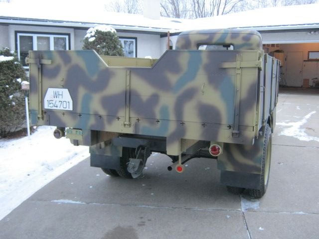

I am nearing completion on another WWII Ford truck for the German side. It will be used to haul an anti-tank gun. Here are some pics.

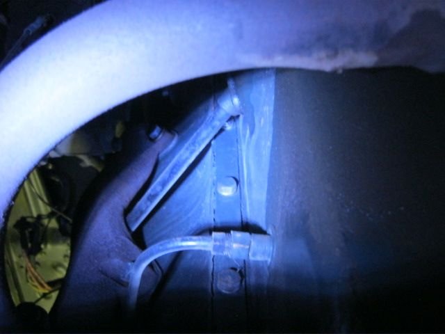

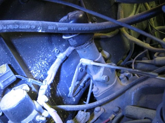

The problem is that as I stated the truck is almost ready. I do have a minor oil leak. It is a rebuilt motor 59AB with 42-46 rotating assemblies and there is oil leaking from a small breather? on the front of the oil pan. I have other flatheads but they don't have this feature. Also looking at the VanPelt Sales exploded drawings of oil pans none seem to match the one on my truck. Mine must predate the 49-53 time period. The engine rebuilder was no help. My mechanic assures me there is no blowby and that the breather cap on the top of the manifold is clean and working correctly. Can anyone tell me why oil might be shooting out this opening or if I even need this on the oil pan. I took some pics.
The fixture has a drop of oil hanging from it so that is the culprit. Leaks after it warms up. Any ideas for a fix or a reason for the leak? - Mike

So... I think my mechanic and I made some progress on this today. Checking my receipts I ordered a gasket set for the rebuild of the engine which came with an oil pan gasket and then checking the picture of that product (Speedway) it shows a gasket that would go on the 49-53 engine. VanPelt does have an exploded drawing of the correct pan if you look at how to rebuild an engine under the oil pan section and so looking further, MAC's offers an oil pan gasket set with the correct cutout for this oil air breather contraption. I think once we pull the pan we'll see that we have no gasket material where there should be some material. Laborious but I think this will solve it.
Here are the two oil pan views
Ford Flathead V8 Engine Overhaul - Section 128-129 - Pg 1
http://www.vanpeltsales.com/FH_web/F...g_1949to53.jpg
We'll see.

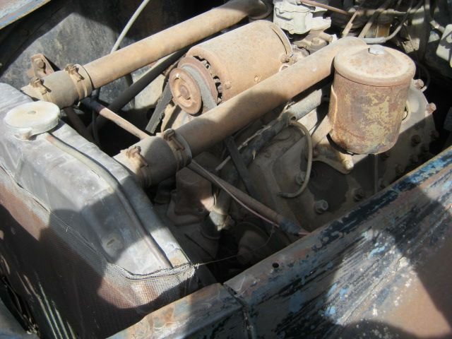

Oh, here is a before picture (almost - the wheels had been cleaned up a bit in this pic) My brother and I got this one from North Dakota as a parts truck for another 41' but just couldn't leave it alone.

Nice looking '41 in German camo! I've noticed a lot of '40-'41 ford trucks in the German convoys on my WW2 videos.

Very nice looking truck.
but you need 6 lug wheels and a straight six instead of the v-8 to be "more correct"
Thats ok though, you've done a very nice job with it. keep up the good work
