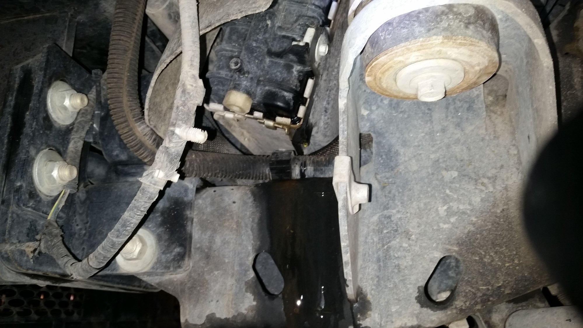

im getting high EOTs

I think i found where the leak is coming from

Im lucky that i still have 4 months left on my 5yr/100k warranty I hope the radiator is included

yeah, typical spot.
It is not going to be covered but you can ask. Have the Service Advisor just look the part # up to see.
Perhaps in conjuction with the high oil temps it can be covered as a contributing factor..ask.
It is a stretch.

Just a quick update:
I took the truck in this morning. They told me the radiator is broken and not under warranty. They also said they diagnosed and could not see anything wrong with the oil cooler. Told me that I was seeing high EOTs because of my radiator. Now they want to charge me $1700 for a new one and a $250 diagnostics fee.

Buy an aftermarket radiator is my suggestion.
Don't buy their diagnosis. One has nothing to do with the other unless you are low on coolant.

Is there not a TSB that would cover the cost of these radiators? You would think that with all the problems with these 6.4 radiators they would have been recalled already.

Nope. There was a TSB in late 08/09 where they were covering them. But it was superseded.
they do the same thing all the way up to 2015 models.
Cheap radiators.
