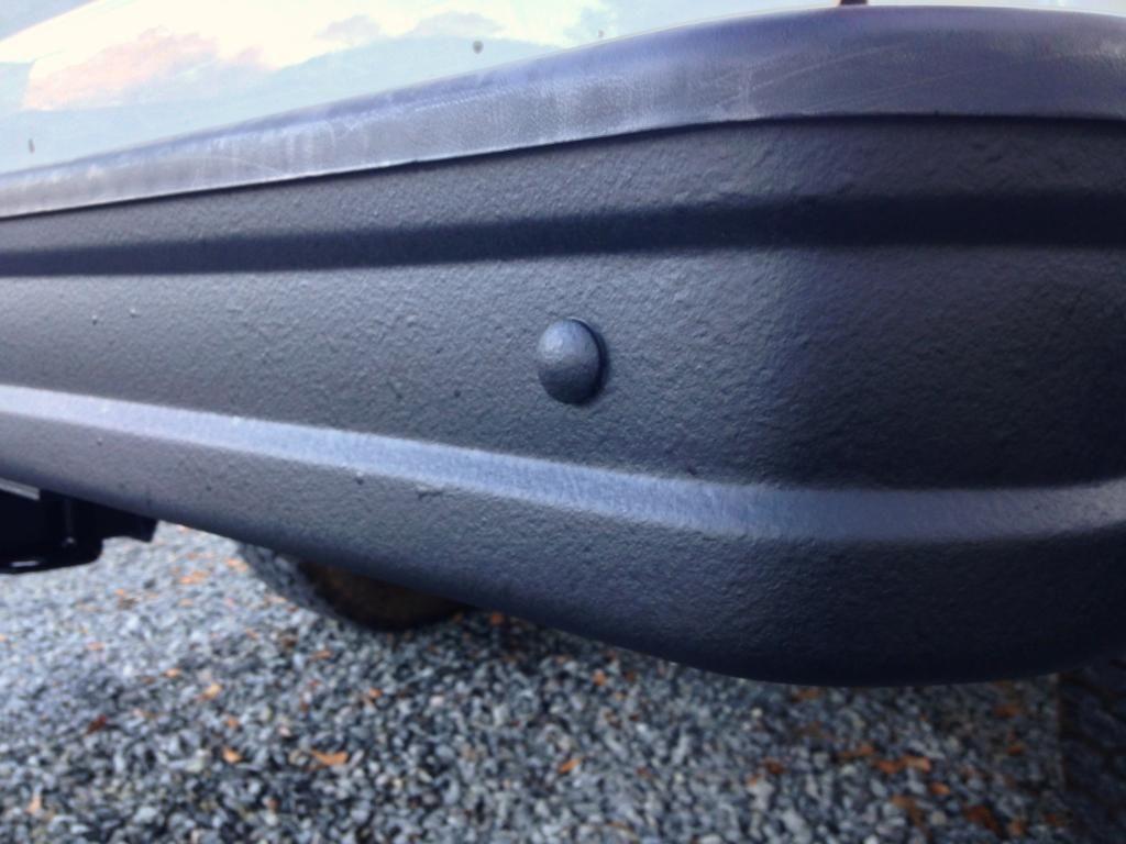

Well after refinishing my front bumper, the rear was ugly as a fart in church. I had planned on using the same Duplicolor satin black wheel paint I had used on the front but once I got to the parts store, I had another idea.....
Bedliner. I looked online and people had nothing but good to say about this stuff, Duplicolor Bed Armor. So after removing the plastic cap from the top of the bumper (pain in the butt!), I used a 120 grit sanding sponge, water and Purple Power to sand it thoroughly and remove any contaminates. I then went over it with a red scotchbrite and more detergent. When I was done, I rinsed it with high pressure water and blew it dry with compressed air.
I then used Duplicolor self etching primer to prepare it for the coating. After it flashed off, I shook the Bed Armor for a couple of minutes and started to spray. It took 4 light coats to cover it completely and create a good texture. I was glad the primer was green as it allowed me to make sure of even coverage of the Bed Armor. The coating requires 20 minutes between light coats to avoid sags.
I am VERY happy with the result. It looks great and should be very durable. Once I build my sliders/steps I will use this product again.
Anyway, some pics.

Looks good. Last bed liner spray I used came out like spray paint, was extremely disappointed with it. Might try that type next time

I had used some before that was pretty smooth too. This being a true polyurethane product and "rubberized" (and $13 per can) made me have high hopes. I used about 2/3 of a can on the bumper and coverage was very good, just remember that this product will not tolerate super heavy coats without sagging. Many lighter coats are truly the only way this will work well.
Prep, prep, prep... sand WELL and use a strong detergent and I ALWAYS use self etching primer.

Looks good! I used that stuff on a down n dirty rocker panel repair for a friend. Welded in new sheetmetal, but he didn't want to spring for matching paint. Came out great, and has lasted two new england winters with no issues.

I was surprised it hadn't chipped off, being on the rockers. The thought at the time of repair was even if it did chip, it'd be easy to touch up.
