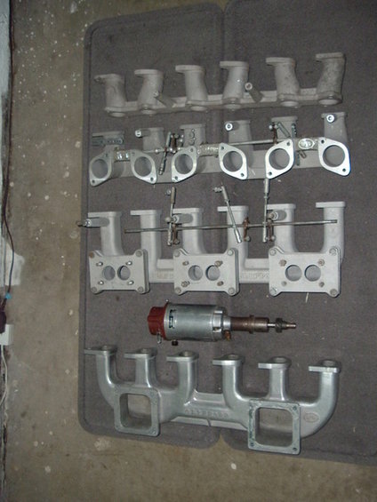

I don't know what 3-2V's will do for mileage but I'm planning on running 3 Autolite 2100 1.02 2V's, with a synchronized linkage, in my 54 F100 project.
Originally Posted by AbandonedBronco View Post
Three? Why not go for six? =P
I can't imagine tuning more than one carb at a time, but it seems like it'd be a fun challenge.
I would think it'd be ideal to have a three carb setup and tune each one for a different part of the power band. At cruise, only one carb is even open, and have it as lean as you can go without negatively affecting the engine. Then, tune the others progressively richer.
I may need a third 300 to play with.
None of those intakes are actually 6-1V intakes. The top two intakes are for Weber Side draft and Down draft carbs. I use to have one of the Weber DCOE intake set ups many years ago. They sure do look purty.
Here's a some pics of those set ups ( not mine ) .
Down draft:
Side draft:
I think 3-2V's with a synchronized linkage is the best way to go. And if you want to go even better, set it up so it's one butterfly per cylinder ( like the Weber set ups above ) . You can't get a much better air/fuel distribution without going multiport EFI. Plus it's that much funner trying to get everything sync'd up.
You can never have too many big 6's to mess with!! I've got a whole collection of 240's and 300's just waiting to be built.

I had no clue on the intakes, aside from what they look like. Just some pictures I've collected over the years.
Heh, those setups look like they could be really a lot of fun...
I wonder how they'd do off-road, and in a big truck.

I've owned two of the four intakes in that picture you posted. I had the side draft Weber one and a few of the dual carb intakes ( wish I would have kept one ) . Now I'm saving my pennies to buy another dual carb one for my E350.
They are a cool set up and it's hard to beat them for performance ( other then efi ) . But they are fun to tune and they aren't cheap! But you can set them up to do just about anything you want them to. It's been over a decade since I did anything with the Weber's. I believe they required some modifications for off-road use but it is doable. A Bronco with a 300 and triple Weber's sound good to me!!
