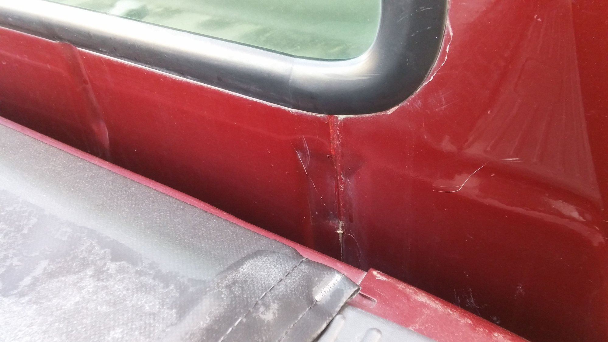

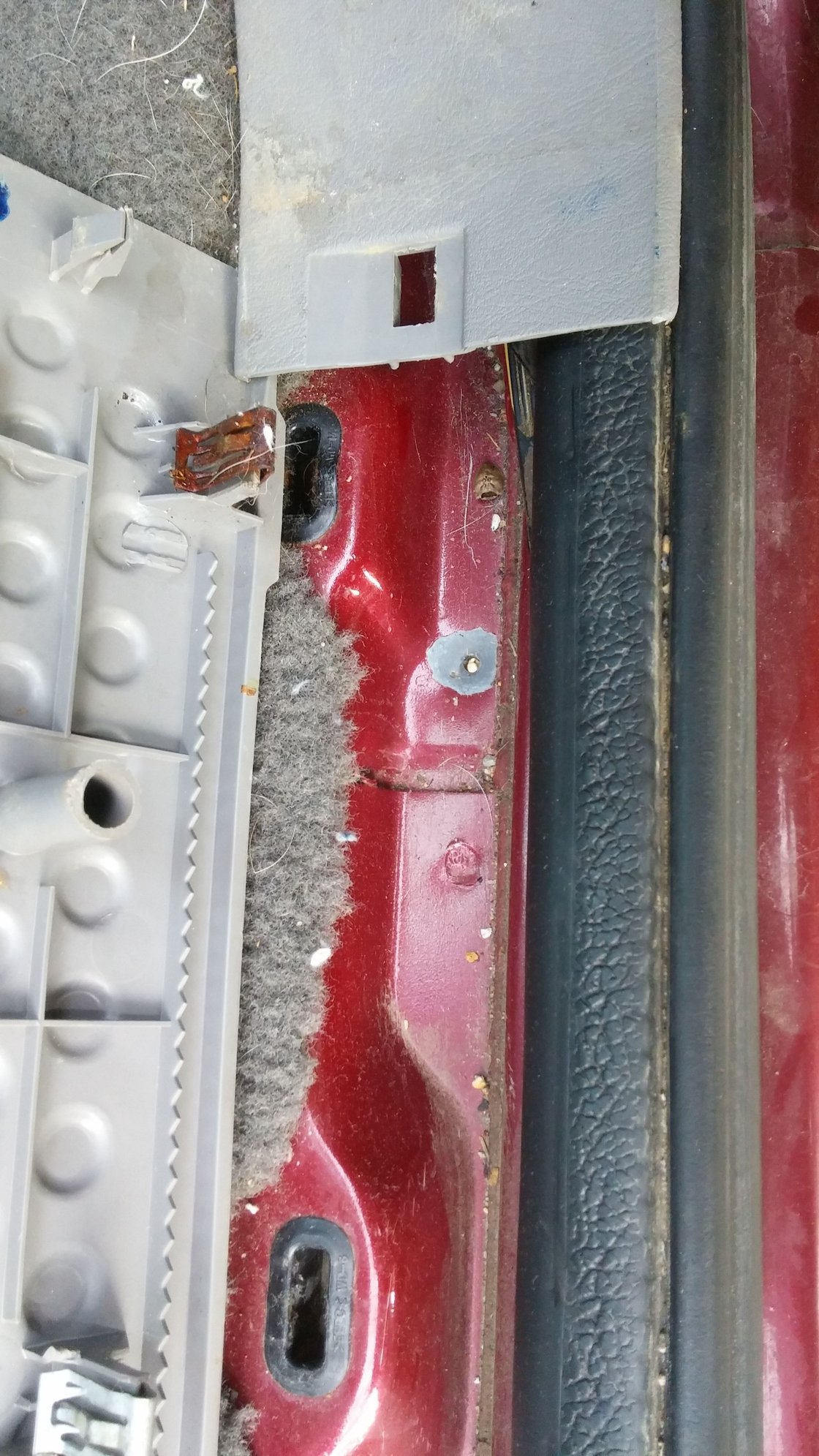

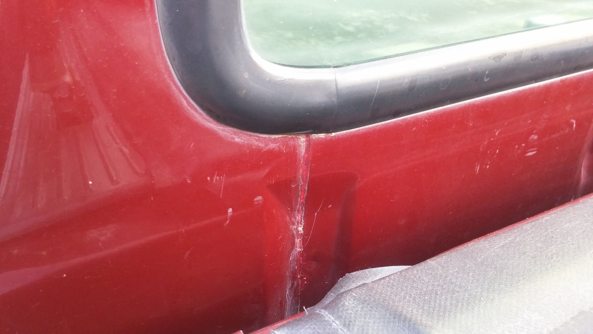

Pull up the plastic step plates and see if there is water, or evidence of moisture there. Had this last summer and had to seal up body lines (seams) on back of cab under rear window with body filler. Will try to do pictures tomorrow. If the plate metal clips look like they are starting to rust, grease or oil them, they are getting difficult to find. Can't find metal clips, have to buy whole step plate.

This seam under rear window was leaking
This seam under rear window was leaking.
passenger side drain hole. Grease up the metal clips on step plate.
Make sure this drain hole is not plugged
Here are the pictures where the cab was leaking. Found this by taking the interior panels out and running water over the seams.
