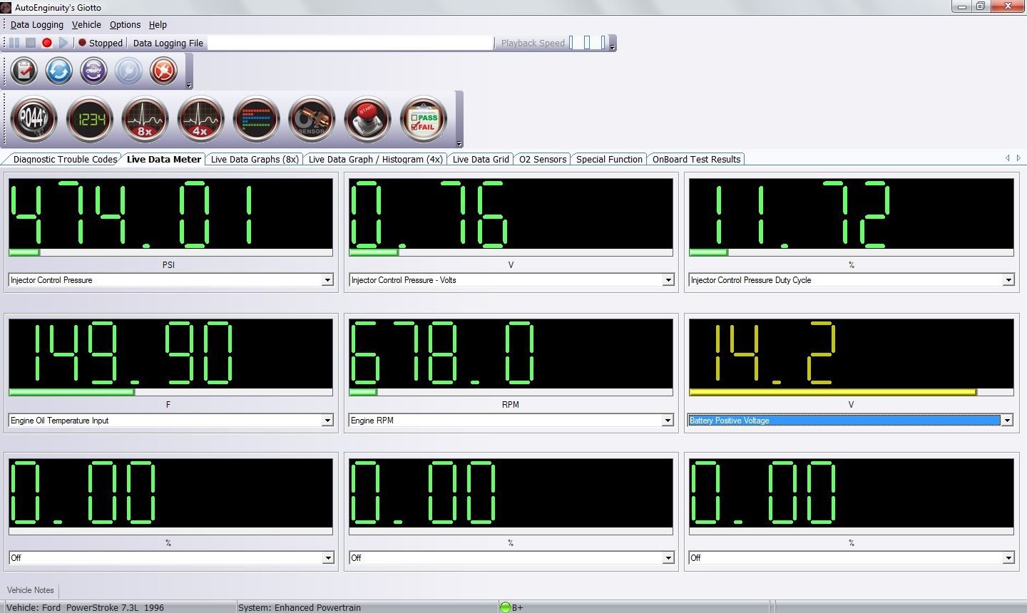

ok cleaned the pigtail real good. Idling ok. Here is a screenshot of values:
Values look ok?

and now she seems to be running ok again. Here is another snapshot after a little warmer:
Thinking I got some water in the connector. Used electronic parts cleaner and a little compressed air (from a can) to clean it. not getting CEL anymore. I guess I should watch it and see how she does....

Those numbers all look good. In the first one, the ICP was a little high for idle, but I figured it wasn't up to operating temperature. I think you are right about the water in the connector. I would check the 42pin as well. Clean it up really well with electronic parts cleaner. Get the engine good and hot, take it for a couple of hour ride.

Sorry... not 100% sold on good yet. IPR is a little high for that ICP and RPM. Spec says 9% to 11% IPR, and considering the range - you're about 7% above max. If you have single-shots, 10% is too high at 475-500 PSI ICP. Not being at full engine temp may play a role here, I'm not sure. How does it look at full temp? What does the ICP say with KOEO?
KOEO test is not temperature dependent.
All of this assumes stock program.

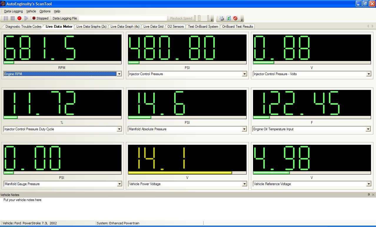

now I am scratching my head. I went to this page:
Riffraff Diesel 7.3L ICP/IPR AutoEnginuity Set-up | Ford Diesel Performance Parts Blog
and looking at this screenshot compared to mine:
I see the following:
Riff Raff value / My value
Engine RPM: 681.5 / 678
ICP PSI : 480.80 / 474.01
ICP Volts : 0.88 / 0.76
ICP DC : 11.72 / 11.72
Engine Oil Temp: 122.45 / 149.90
Seems pretty close to me - or am I way off here? - and I am no means an expert! Learning here!

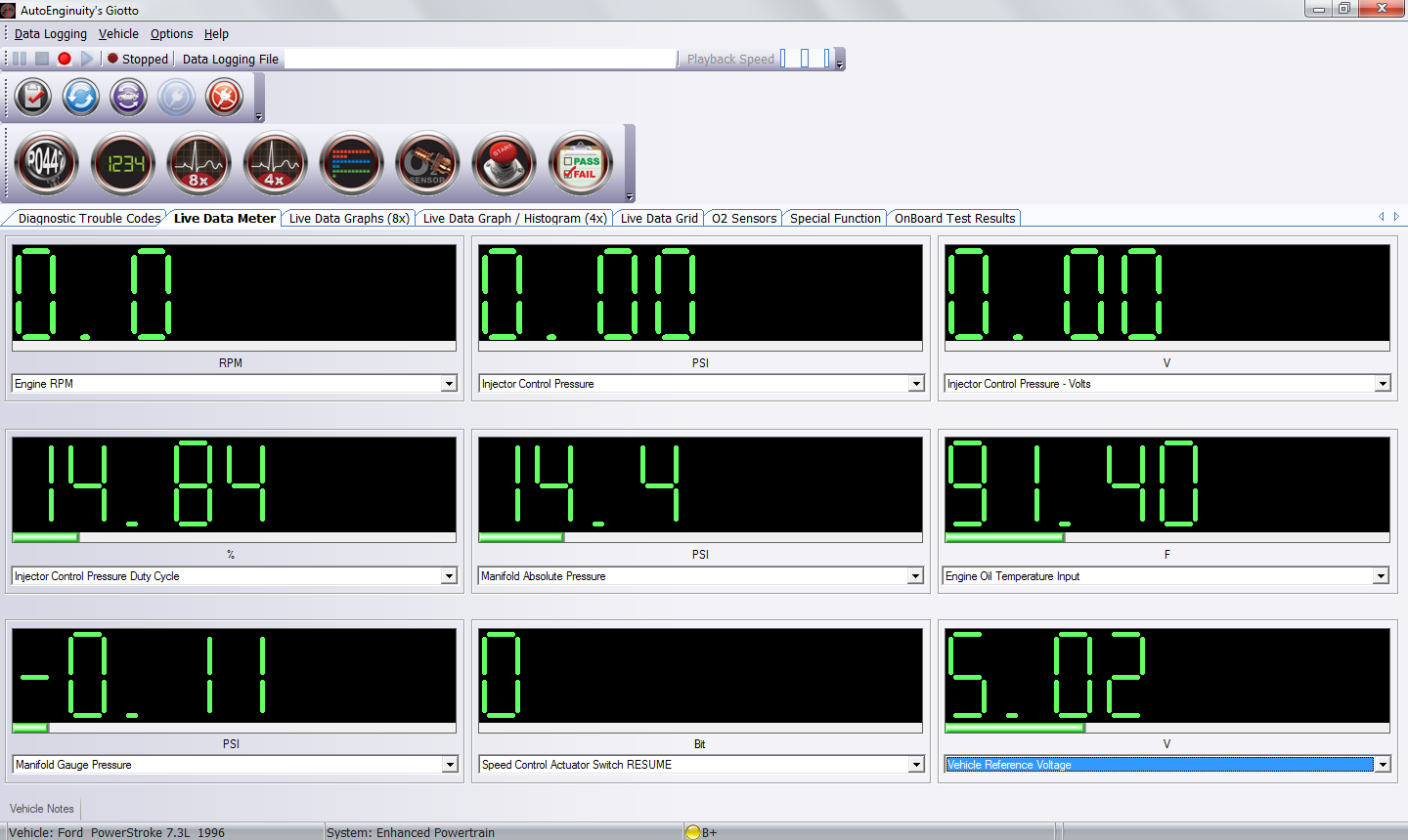

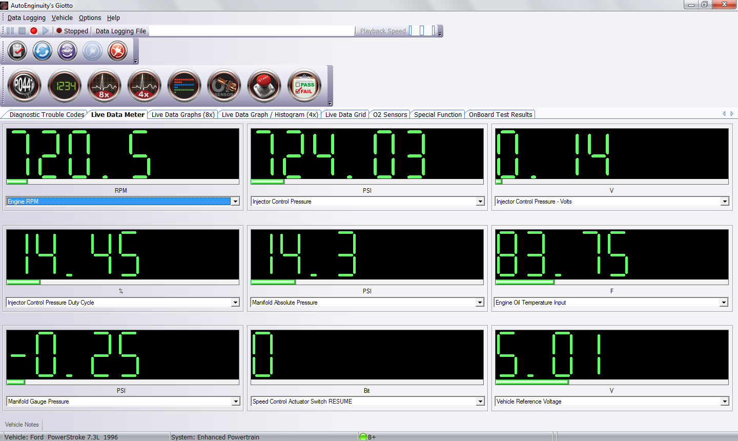

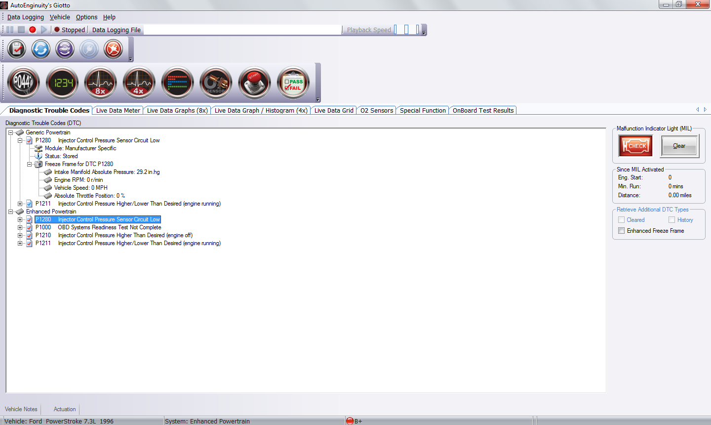

Well crap......spoke to soon. Went out to the parking lot and not so good. CEL is on again.
This is my KOEO results:
Got the error code again:
Here is just after startup:
Here is at 2000rpm:
Cleared the codes and got this:
Here is the KOEO Test results:
I did notice that 724.03 was constant and did not change unless i blipped the gas. I assume I was in default/bypass mode. I unplugged and plugged in the sensor and nothing changed.
So I guess it is safe to assume the sensor is intermitten (worked ok this morning to work) and should be replaced? Or should I start with the pigtail? I noticed it is not a tight fit - a little loose...
