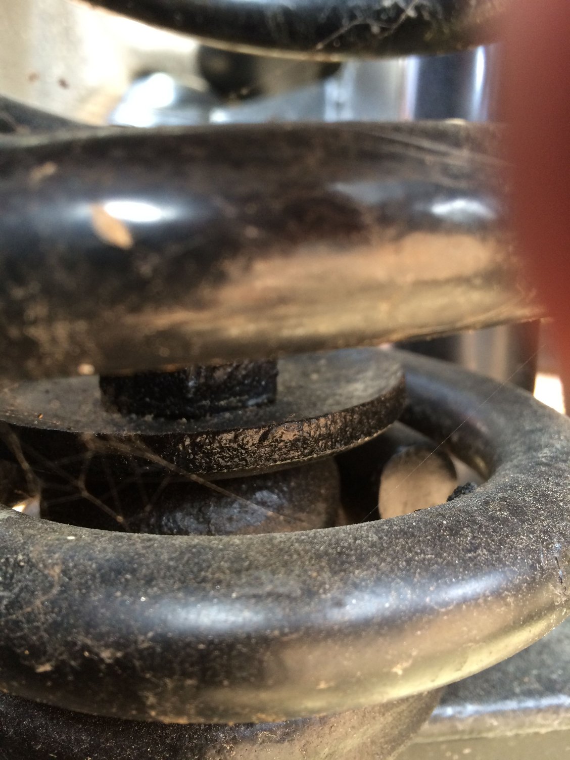

Here is the bottom; the bottom of the spring is smaller in diameter; the large washer keeps the bottom of spring on I-Beam

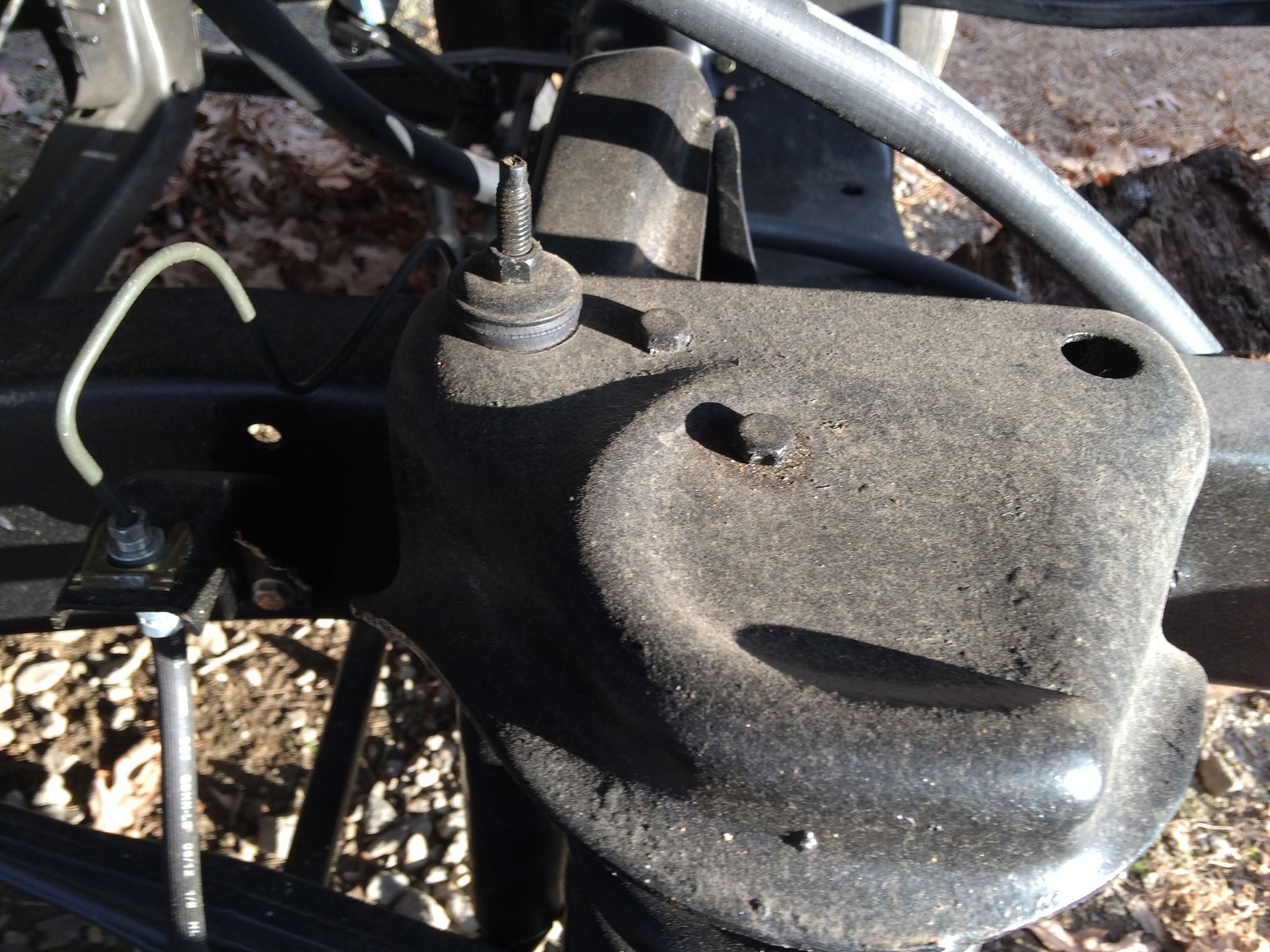

Here is the top; the two bolts hold the upper retainer
Here is the RH side on a 1966 F100 2WD

Thanks pal... I understand now...is the retainer your referring to a clamp that holds the top of the spring? If it is... Mine are missing...can I buy it somewhere? Are they really neccessary ? The spring falls out now..since the coils were cut.. But if I put the stock springs back in.will they still pop out without the upper retainer or will they sit in the pocket under pressure?

The top retainer is pretty simple and can be easily fabricated; I cannot recall seeing them for sell. I would consider the retainer necessary; want something in there to hold spring in place if you hit a big bump.
If you look at the top piece you can see there is a groove the spring sits in; the retainer holds the spring in that groove which both prevents the spring from rotating and from moving away.
