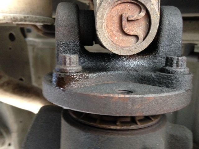

I went ahead and got under my truck today to replace the rear end oil, and when I went to check the fill plug to make sure I can remove if before I start the job I noticed this:
I see it's been leaking, and slinging oil onto my fuel tank. This may be a stupid question, but do you think this is the source of my problem? I stuck my finger in the fill hole, and I didn't feel anything so I added some oil just to see how low it was, and it only took a little bit before it started overflowing. So now I'm really at a loss. Any idea of what I should do? Thanks for listening.

Your pinion seal is "done". Have it replaced by someone that is qualified to do so. Improper torque of the pinion nut will cause noise and premature wear of the ring gear.

No, the leak has nothing to do with the limited-slip differential chattering on turns. You may as well let somebody do both jobs now that you have found the pinion seal leak.

Rear gears can't slip, what you feel is simply best described as "clutch chatter" as the limited slip clutch discs slip along against each other in a no load situation. Loading them (hit gas WOT) will lock them, but spin the inside rear wheel on those turns which wears tires.
When new, they have new lube with new additive, and they slip "smoothly" so you don't feel it. The lube and additive prevents their wearing out. Yours has 72,000 mile old gear lube and friction additive so they "chatter" like finger nails on a chalk board without the screech.
First thing I'd do is check my gear lube level in there.
If really low, I'd R&R that pinion seal.
If not much low, then I'd just use my hand evacuation pump and pull the fluid out until I couldn't get more out, then put in friction modifier additive and top it up to fill plug with recommended gear lube for now and monitor it.
I say that's what I'd do as your seal leak evidence looks like long time fine seepage to me but it might look different first hand and up close in person.
Something else that may explain it is a factory overfill. In 2013 "Wife Unit" spied what turned out to be a '08 Mustang GT 5 spd with very low miles she (and I) liked. We took a drive in it, I looked it over, and saw that it was a well maintained car .... and while I did give it a good looking over, I never put it up on a lift. I get it home and first oil change after a short drive I find a couple drops of gear lube hanging under the rear center on the snout. I then removed the fill plug to check rear lube, it started coming out the fill hole so it had more than enough and there was a short "woosh" sound. It too had some on the chassis and floor pan.
I could not change the seal then that day so I watched it and every so often would back it up on ramps to check and it was always full, but still there'd be drops hanging. I could wipe the drops off (wrag with 2+2) and it'd stay dry until next drive. No leaks just moving car short distances, only after drives long enough to heat it up.
So I pulled the axle vent (in the cap is a short weak spring with disc valve that opens after a slight pressure build up but stays closed otherwise like if in a "creek car wash", etc .... but on the Mustang the "rattle cap" as I call it was crimped on tight enough that there was not much "rattle" room so I thought maybe the spring was just "preloaded" more than was healthy.) ... and I fabbed a fitting for a hose and ran the hose up to a loop on frame and then back downwards into a frame member and no spring loaded vent.
This is how my '77 rear axle vent is, it just goes way higher in a 4x4 to top of hose and ever since when I am under there changing oil or whatever, no more drops of gear lube and stuff stays clean. The "loop" is really just a high "U" turn to create and air lock against water. I have a seal for it and if ever I see any signs of seepage again and there's no stoppage in that hose, I'll replace it then.
