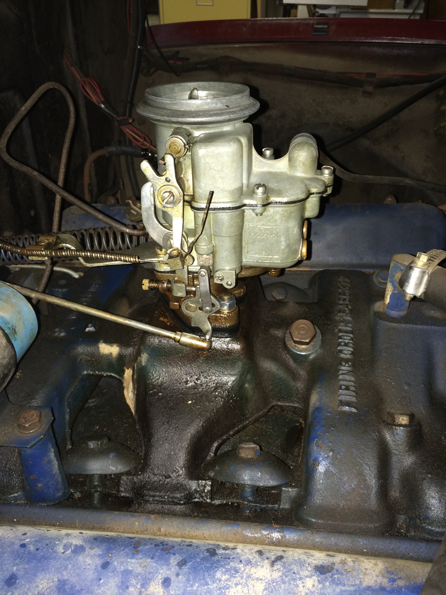

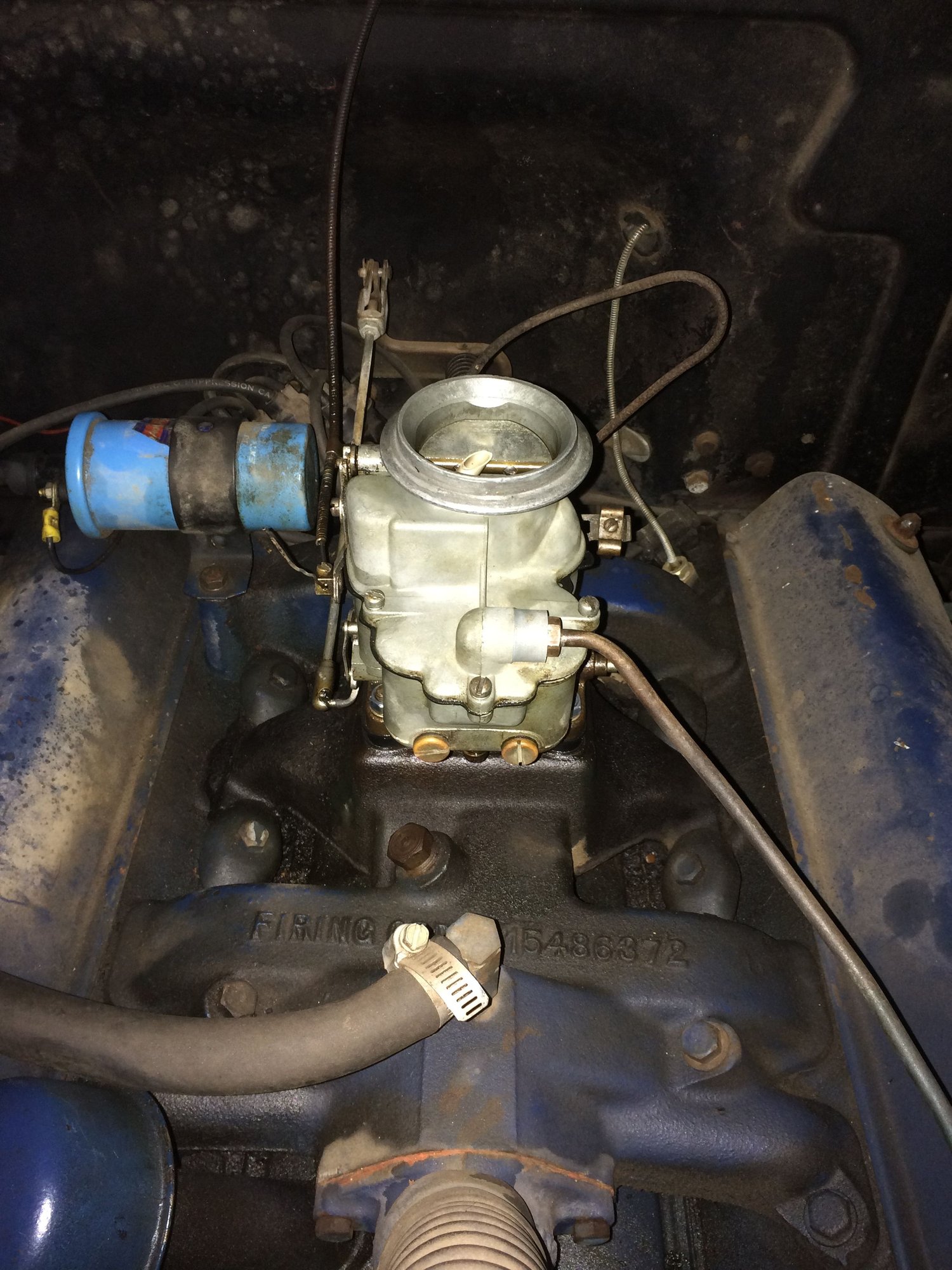

First let me say, Thanks for letting me join the forum. This is my first post but am sure it wont be my last.
I have a 53 f-100 that has been I my family since 1973. Grand father, me, daddy and back to me! It has a 54 model 239ci in it and up until this week had been running pretty good.
I recently rebuilt the carburetor and it has been running fine. I drove it up town last week and had some brake issues on the way home. Well I rebuilt the brakes and it has been sitting for a week or so. I went to crank it to drive it so I could make sure the brakes were right and the carb was pouring gas everywhere!! Cant figure it out. Thought maybe the float was stuck so I took the top off but all seemed fine. Any ideas?? tried to post pics of carb but don't know how right now.
Thanks from a confused f100 owner!!

Nice looking engine picture. Please post pictures of the truck.
