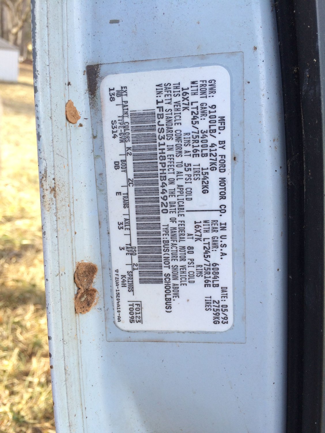

So my Dad got in this E350 this week that I can get the rear end from if I want. a few questions that I have not been able to clear up. My F250 has a K Spring and this van has an H, I assume the H is a higher load capacity but can not find info to say. The van has a Axle 33 and If i found that correct it is a Dana 61 with a 3.54 gear. is the dana a step up from the ford 10" will the springs change right over? My thought is to find a 4.10 gear for the dana and swap the whole thing over. is the drive shaft the same or would it need cut or lengthend? Your thoughts and concerns please and thanks.

No the Dana is not a direct swap, vans have a wider frame so the spring perches have to be cut off and welded back on in the correct spots. The 4.10 ratio was common in E and F series 3/4 ton trucks and most of those will have a semifloat axle same as you have, so keep an eye out for one of those, even of you do stumble on another van axle it wouldn't cost much to have a competent welder move the perches, and '04+ vans also have rear disc brakes.
