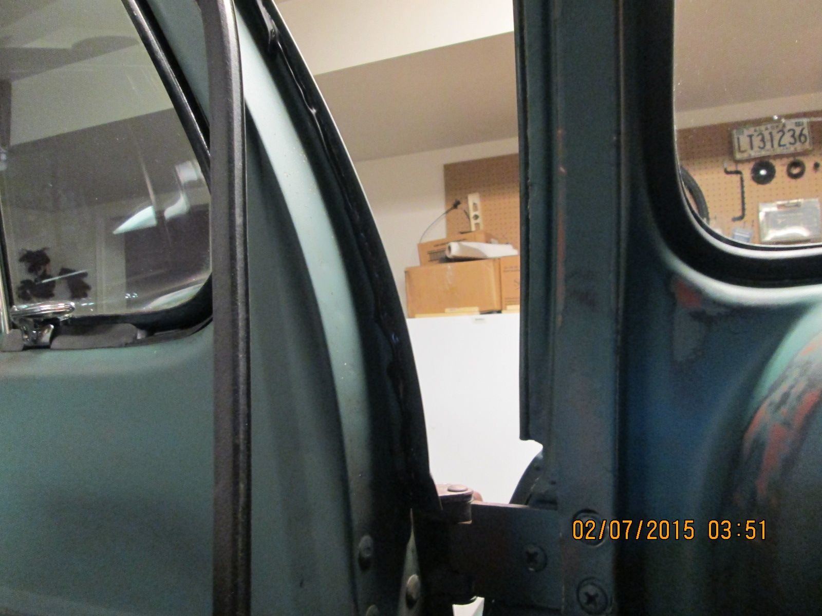

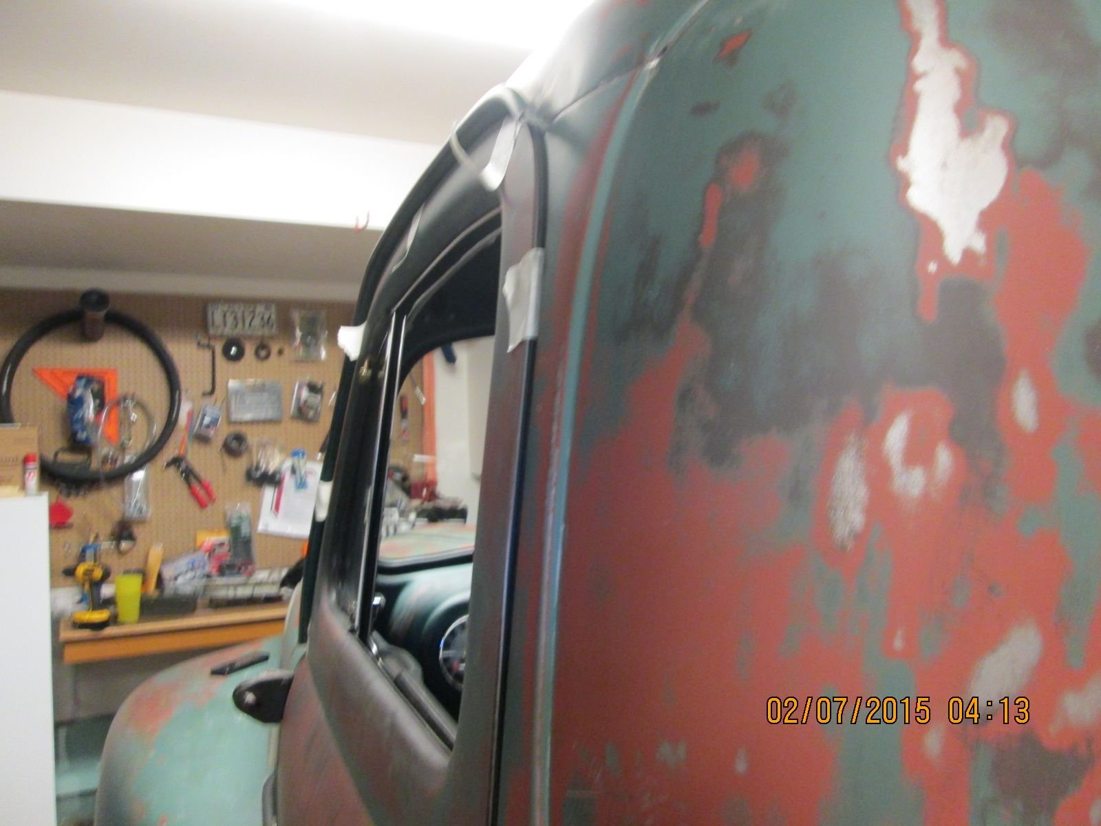

Well work took me away for about a month,but I did get a few things done before I left. The glass went in like a dream with Dennis Carpenter rubber bought from Classic Haulers:
Installing the rope. I would have done it myself if I knew just how easy it was....
Back goes in from the inside out.
Just push lightly on the area that the rope is being pulled through and take your time. The one piece gaskets were great!
Nice and clean, and it looks good.
We also got the rubber most of the way around the driver's door installed:
For the life of me I can't remember where I bought this weather stripping but it seems to work and fit very well.
All the hardware to hold it in place. I think I stole some off my donor truck because I have enough for 4 doors..... I'll probably give what I don't use away in the near future.
I found these numbers on the inside of the door near the cab........
This glue works great, but is a little runny.
Tape it in place
Install the clips
Work fast!
Didn't like the way this looked with the clip installed so I took it off to let it dry in place.
That looks better.
Shut the door and let it dry for a day.
Looks pretty good and the door closes as it should.
It might be pushed out just a hair on top.
The gap closes up towards the bottom. All in all I'm very happy with it.

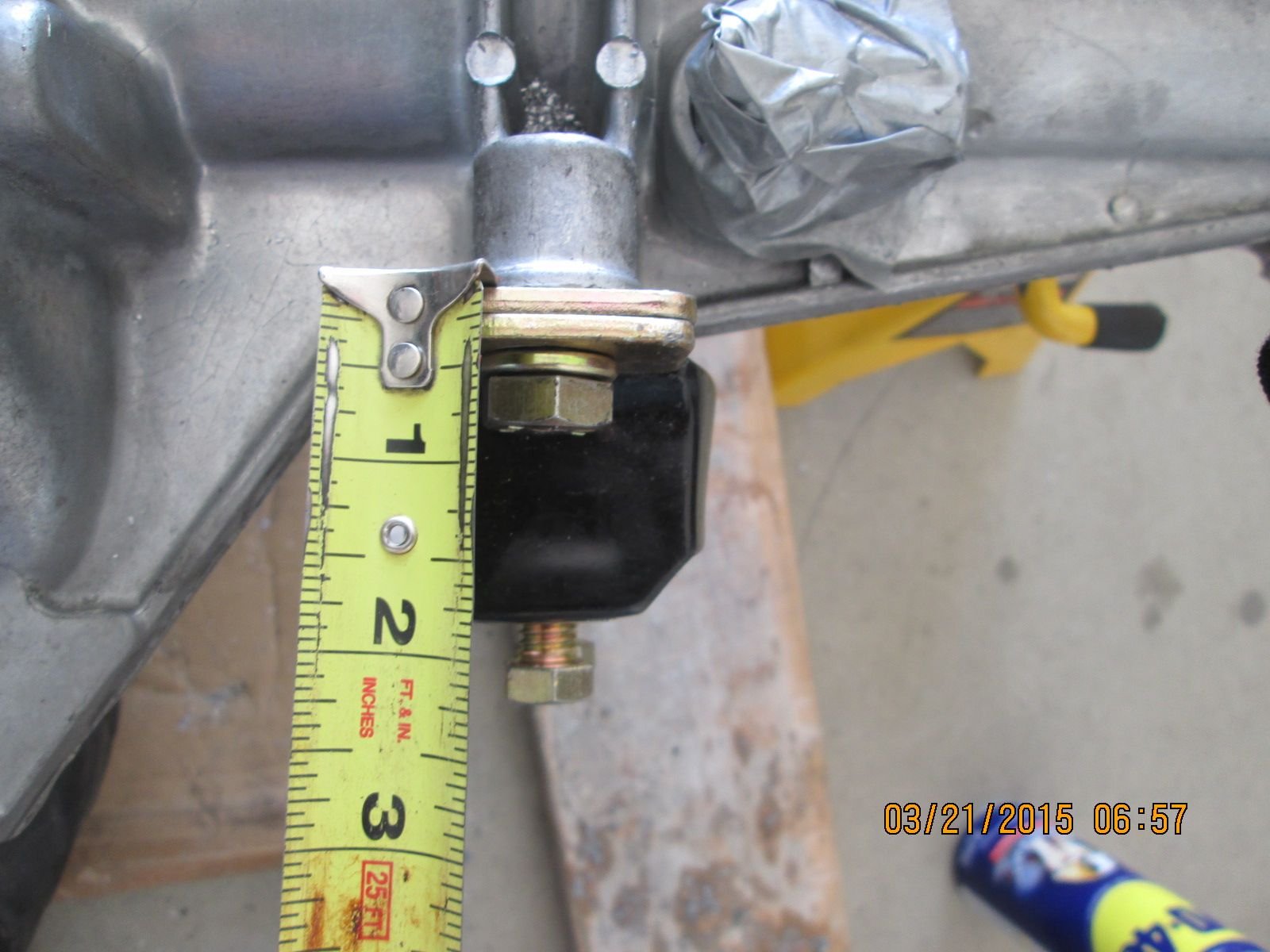

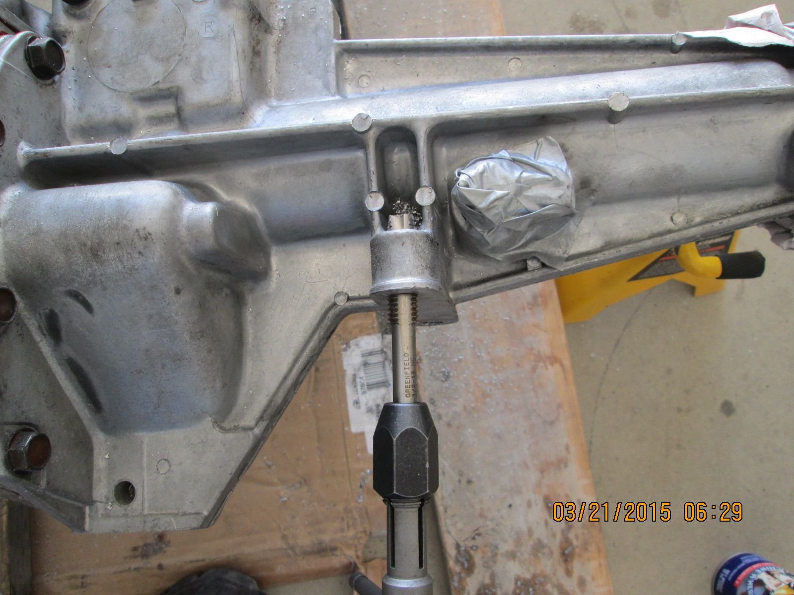

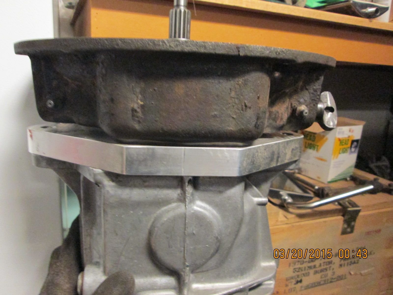

Back to the thread: We had some good progress this week that I have already documented in my T5 install thread, but I'll double post some photos here too. I think the internet is big enough to handle a couple more shots.
I received the adapter plate from Dwight Bond this week along with a pilot bushing. $185 total to get it shipped here (great deal, and a quality product I must say).
I mocked things up a bit to see what was what:
Notice the holes for my hub not lining up. It's drilled for a different hub, but it all worked out after I honed them out.
Honing:
That's better!
I had a little trouble getting the plate attached to the trans,and wrestled with the mount as well (see further details in the T5 thread if interested)
Trans mount complete
Got it all put together and now I just need the pilot bushing and the new throwout bearing pressed as well as the flywheel machined to match my clutch disc:

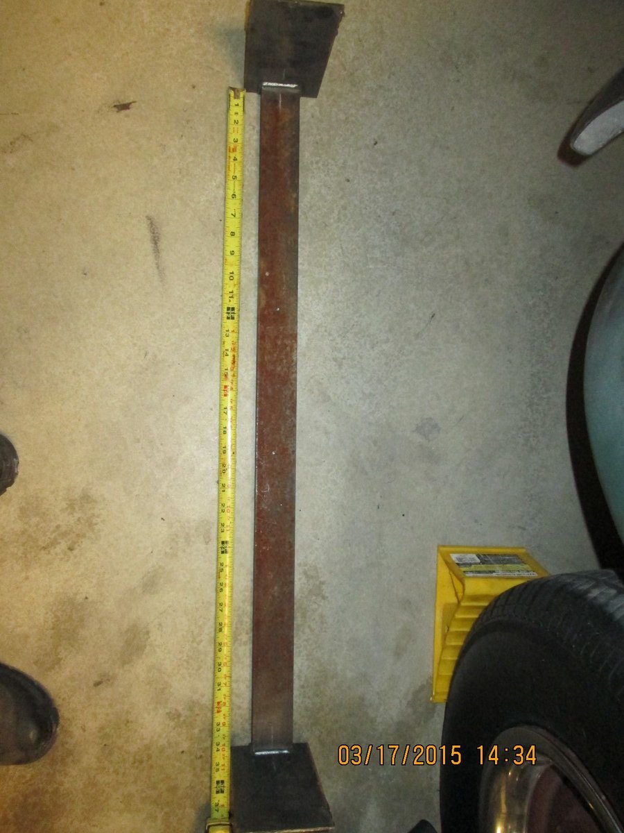

A good friend of mine who recently started welding made up a very nice bracket for the new trans to mount too:
The kids killed the rust for me so I could get it primed and painted:
It turned out great, thanks for the help Jabba! He'll be bringing the welder over so we can brace up the crossmember before hacking it apart:
