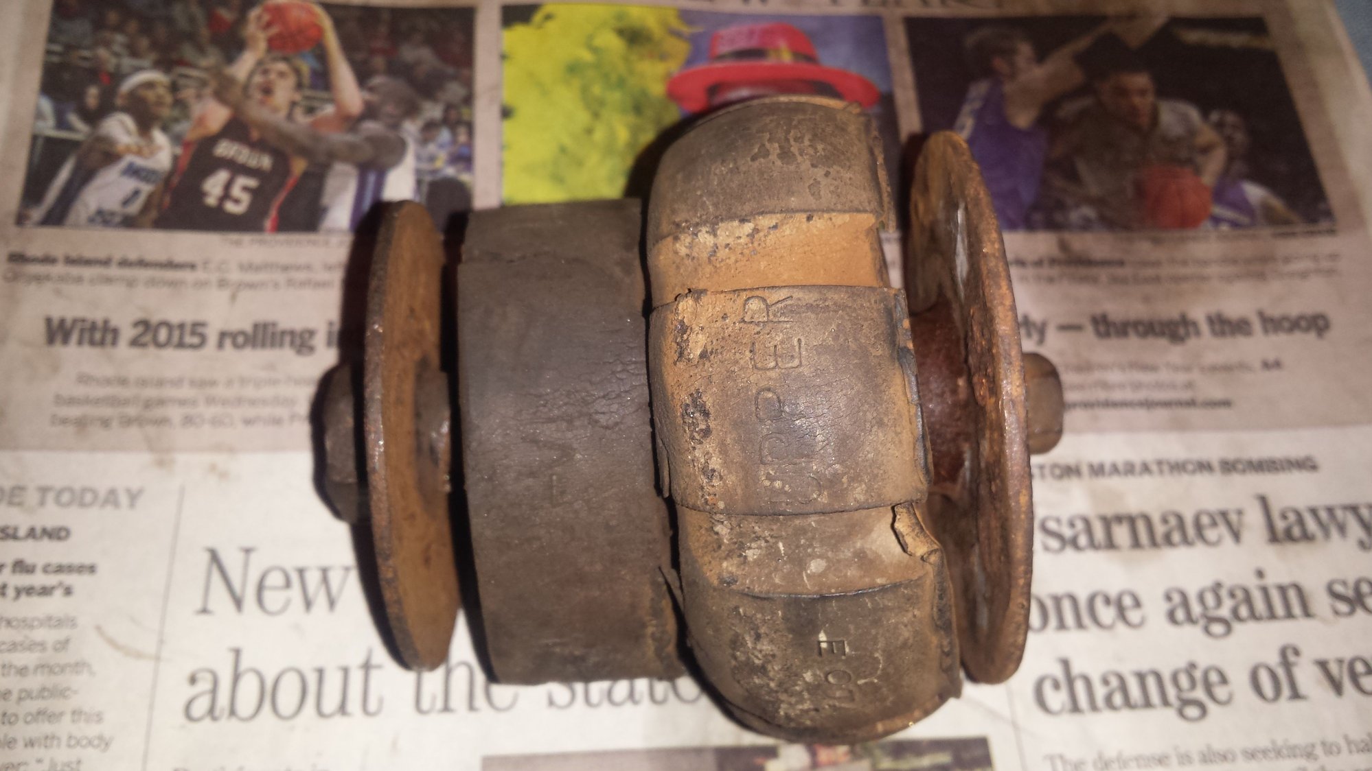

Hey all, I've stumped the local stores so I'm turning to the experts here. I need new transmission mounts for my 85 F-250 4wd with the 300 and NP435.
First time posting a picture I'm assuming it worked.
The left side is the bottom. The first rubber bushing and washer sits below the frame cross member then the second bushing sits between the cross member and transmission mount bracket with the washer under the transmission bracket. The bolt that sandwiches it all together runs from above the transmission bracket to the nut on the bottom washer. That nut is welded to its washer. There is a sleeve of sorts that runs through the assembly that I think was two pieces but is hard to tell now because of rust.
Hope that makes sense...
Thanks!

1980/89 F150/350 4WD & Bronco 300 I-6:
2) E1TZ-6E039-A .. Rear Upper Insulator / Obsolete
LANTERMAN MOTORS in Pratt KS has 2 = 620-672-5516.
IMPERIAL COUNTY FORD in Imperial NE has 2 = 308-882-4323.
BOWMAN SALES & SERVICE in Bowman ND has 2 = 701-523-3257.
POECS PARTS in Erie PA has 3 = 888-864-9305.
VINTAGE PARTS in Beaver Dam WI has 202 = 877-846-8243.
2) E1TZ-6E039-B .. Rear Lower Insulator / Obsolete
MCDONALD OBSOLETE PARTS CO. in Rockport IN has 1 = 812-359-4965.
No Ford dealer, no other obsolete parts vendor has any.
This is the only pic (upper). It should read 1980/89 F150/350 4WD & Bronco 300 I-6 (4.9L).

They are incredibly pricy! One of the store told me the upper mount originally retailed for about $110! He said he would sell it to me at cost which was $60 a piece. Nice of him to offer but I think I'm going to get a couple of hockey pucks and make my own.
