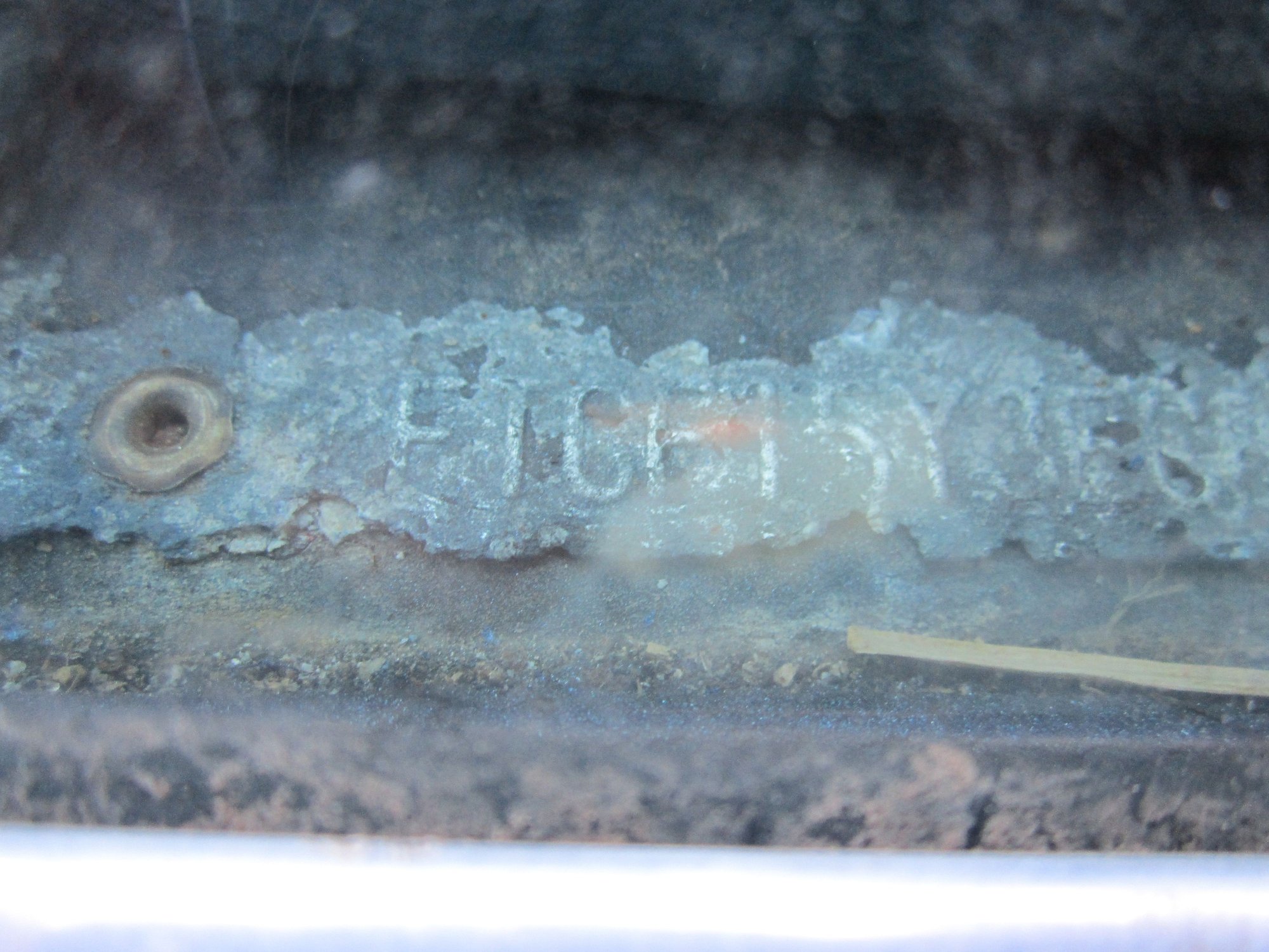

The C5ZF-A carb is a 2100 series Auto-Lite 2V from a 1965 Fairlane/Falcon/Mustang 289.
It's possible that the engine from one of these cars was also swapped in...as a 289 & 302 (not available in cars till 1968, in F100's until 1969)...look identical.
2FT = FoMoCo of Canada Ltd. - Ford Truck - Complete Vehicle.
C = Class C Hydraulic Brakes, 4,001-5,000 lbs. Gross Vehicle Weight Rating.
R15 = This SERIES code cannot be correct, as it's for a Ranger 4WD Super Cab.
Y = 300 1V I-6.
3 = Check digit, FoMoCo use only.
E = 1984.
C = Oakville Ontario Canada Truck Assembly Plant.
B22335 = 1984 Numerical Sequence of Assembly.
Here is the pic of the VIN tag .. bad shape
You might try putting a sheet of white paper over it and rubbing it with a pencil lead and see if you get anything more useful... the angle that picture is taken it is less than useful, especially given the 3 characters in question are near the beginning...

The truck is registered by its VIN, so look there.

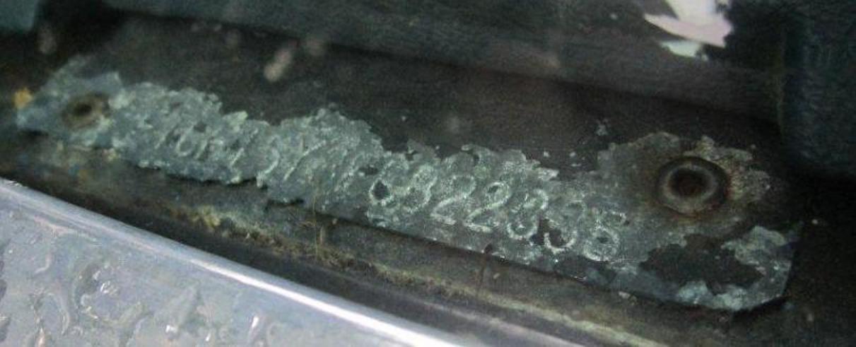

That part (E3TE-9G464-F1C) after a little cleaning then I found the link.
https://www.ford-trucks.com/forums/3...tion-help.html
From Franklin2 back on 07 - https://www.ford-trucks.com/forums/6...ine-parts.html
Old Jan 13, 2015 | 08:20 AM
NumberDummy's Avatar
NumberDummy
Ford Parts Specialist
Posts: 88,826
Likes: 785
From: Simi Valley, CA
^ Looks like F150 = F150 2WD Pickup. ^
