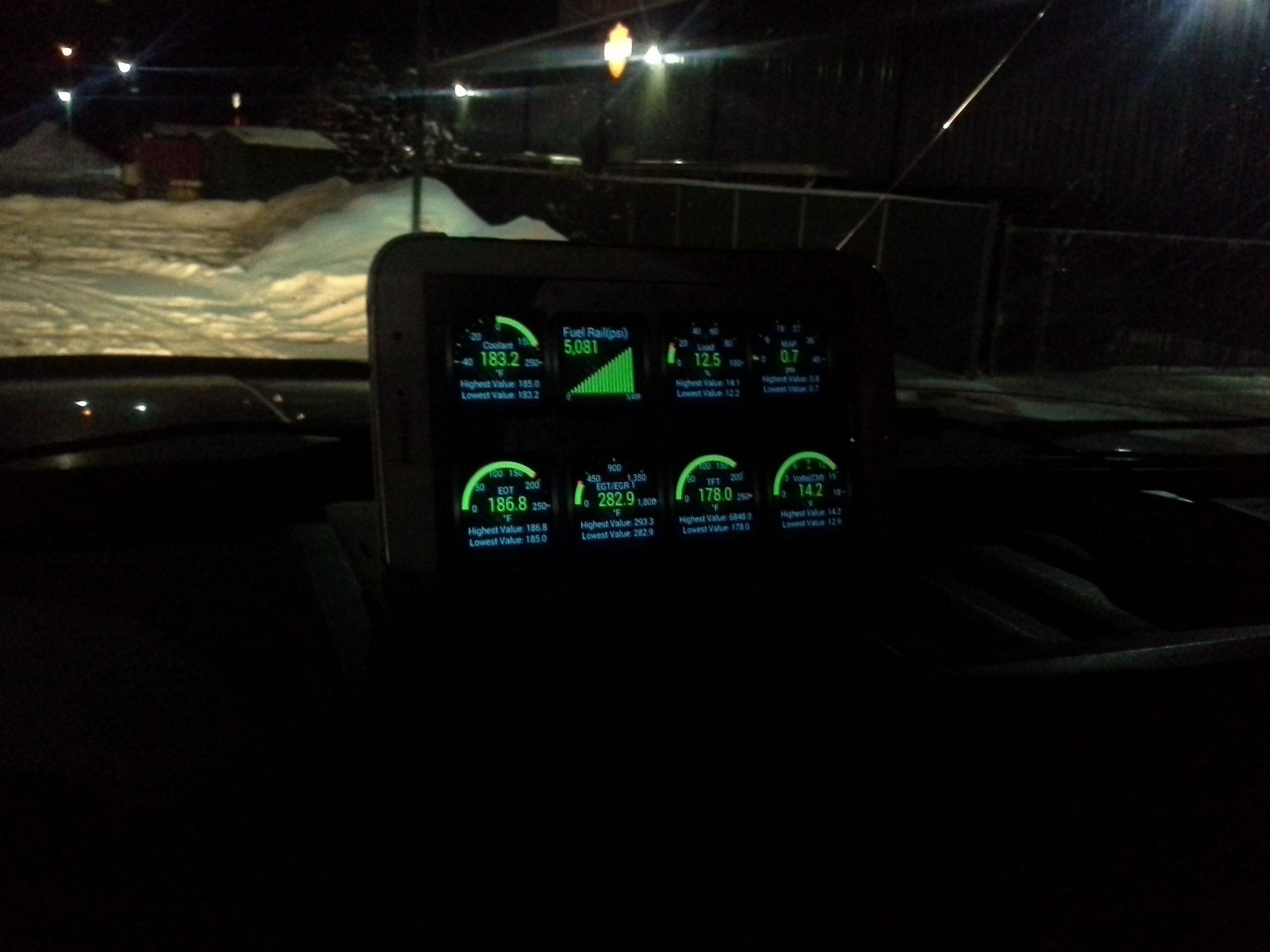

Not sure if you are talking about "pending" codes. I run the Torque App for Android. Program is $5 and the Bluetooth OBD adapter was $20. It can basically read any parameter that your ECU puts out. When I look up trouble codes, it shows "pending" codes in grey - codes that have not been set in the computer, but it needs more driving to verify. Here are a couple of pics of the gauges, but I don't have a pic of the DTC screen.
