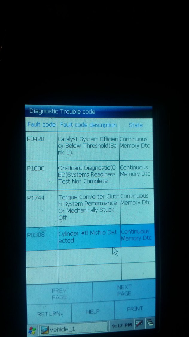

Hi i it picked up a navigator finely got it running intake gasket and coils to day i was driving and all of a sudden it was like the truck was in neutral And wouldn't move shut it off and restarted it and it moved and then stopped again had it towed home it moved again and it's real code p0744 it is now making the sound from the torque converter area and sometimes it will move sometimes it won't but the tranny never slipped I don't know do I put a tranny in it do I put a torque converter on it
Idk what too do <br/>

At first it felt like it was out of fluid but fluid is full and after is stops moving when u put it back in gear the rpms increase like u put it in gear on a lift i guss u would say it free wheels

it h as a 160k it just baffles me it was shifting like a dream everything works and then all of a sudden it was like you put it in neutral then you let it cool down and it goes back into gear and works just fine until it gets hot

That's the result of an internal seal leaking as it warms and expands. The tranny has a mechanical issue and has to be disassembled for repair.
