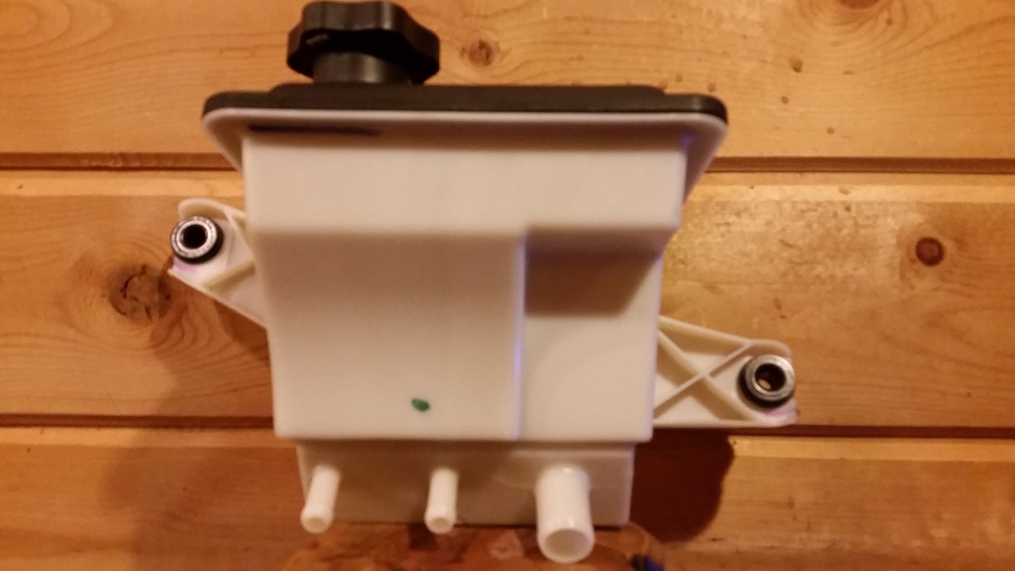

Just so everyone knows, there is no need to cut and splice.the return line in this conversion.
The F450 that came with a V10 and hydroboost, has the same power steering pump configuration as all V10s. What they did different is added a port onto the power steering resivor on the fender. That resivor has 3 nipples.....one is the return for HB pump.
two part numbers needed; f81z3a697bb is the special resivor.
f81z3a713aa is the hose from booster to resivor.
Old Dec 24, 2014 | 07:30 PM
rock2610d's Avatar
rock2610d
Joined: Mar 2013
Posts: 1,576
Likes: 41
From: Wyoming
Here is a photo of the V10 Hydro-Boost PS tank. Note the 2 each return nipples. One for HB and one for the PS cooler or Gear

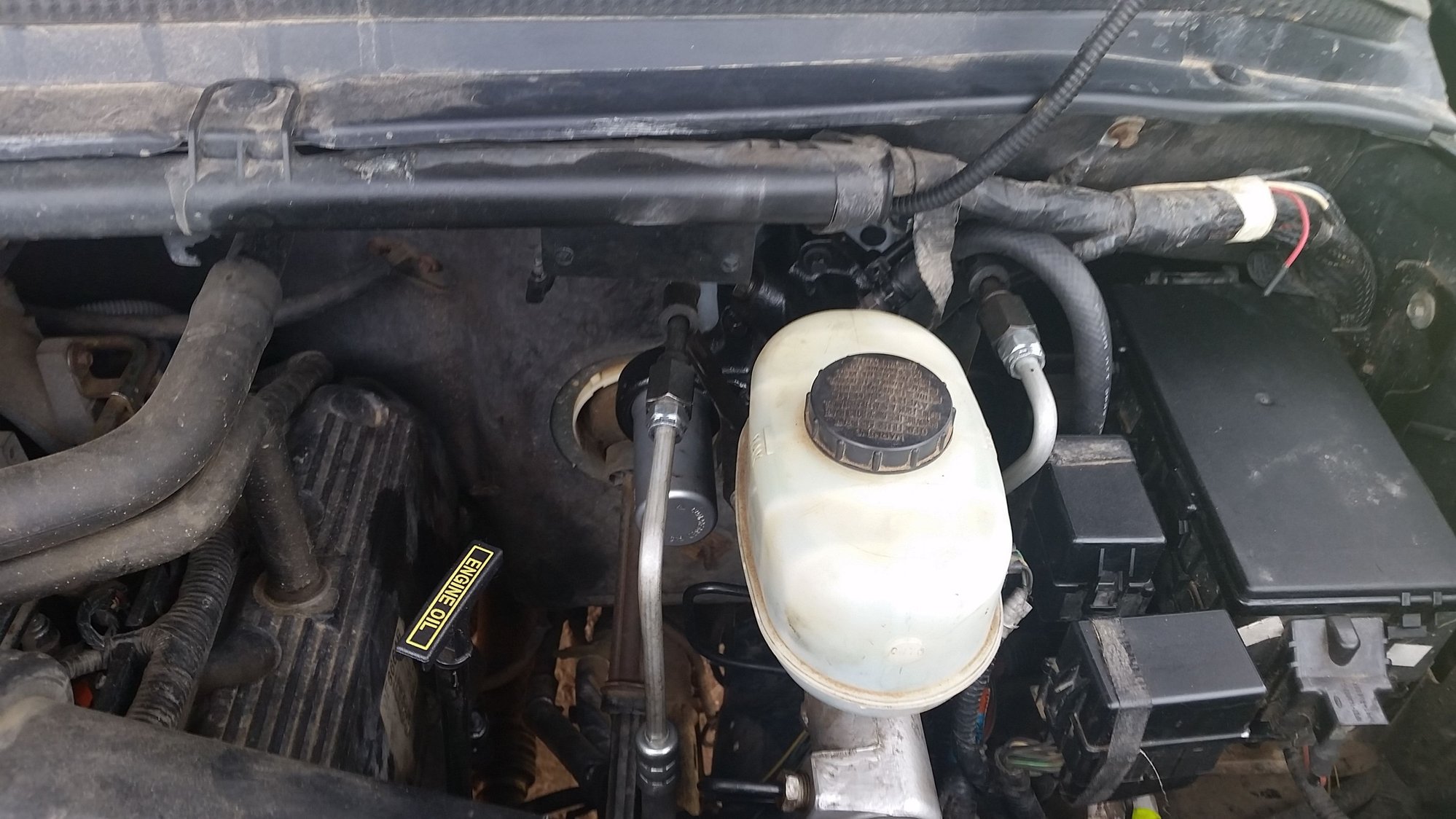

Well my hydro booster is installed.
A diesel or V10 hydro boost break peddle is required. I got one from a salvage yard for $10.
Everything snapped into place like the unit came with my excursion.
I ordered a new 2000 ford hydrobooster, had to go to salvage yard for the metal hose extensions. They do not come with booster.
PS lines for a 2000 f450 V10 with HB fit like a glove.
OEM plastic spacer behind vacuum booster not needed.
HB unit bolted right up to the diesel peddle assembly.
Electronic switch on original peddle hooked up to diesel peddle perfect.
Bleeding system was simple and everything works great.....brakes are LOTS better.
I highly recommend this convsrsion.

Old Jun 21, 2015 | 12:37 PM
rock2610d's Avatar
rock2610d
Joined: Mar 2013
Posts: 1,576
Likes: 41
From: Wyoming
Here is a photo of my hydro-brake booster on EX.
