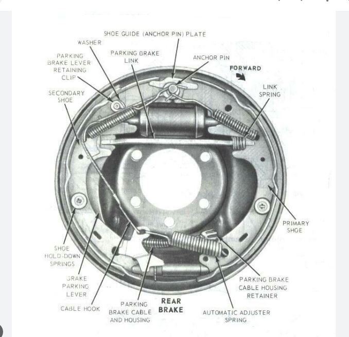

this is what i go by

The smaller brake shoe pad is the PRIMARY shoe and always faces the front of the vehicle.
