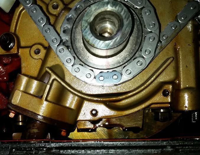

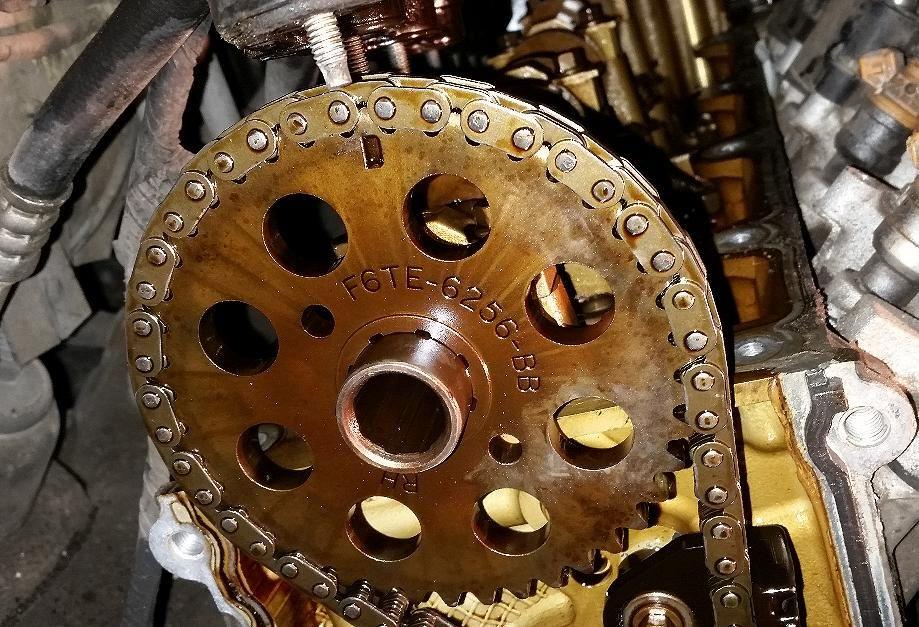

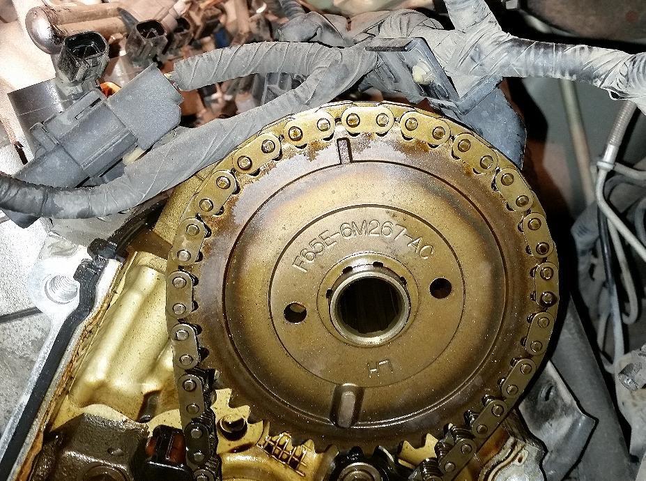

Upon teardown, it seems as the RS-passenger cam has jumped quite a few teeth.... Pics are at #1 TDC (front passenger hole right?)
Crank mark (dot) is at 6:00
LH (driver) cam mark about 11:00...
BUT the RH (pass) mark also seems to be about 11:00... Shouldn't this mark be leaning in towards the center at say about 1:00???
THANKS FOR LOOKIN'!!!

Are you on the comp stroke, none of your colored links line up?
kb,
This is the before teardown with the #1 @ TDC compression...
Installed everything today, colored links on the marks, rotated 2x back to #1 compression to verify no interference... I'll post the install pics...

Old Dec 9, 2014 | 06:06 PM
HappySailor's Avatar
HappySailor
Joined: Dec 2014
Posts: 41
kb,
Timed with new chains...

Old Dec 9, 2014 | 07:13 PM
kbsupercrew's Avatar
kbsupercrew
Joined: Sep 2011
Posts: 448
2000 f150 5.4. timed and no backing plates
Thanks kb,
We seem to be in the same spots with cam marks @ TDC... As well as my before pic, so I am guessing she didn't jump time...
Thanks for the no plates info too...
