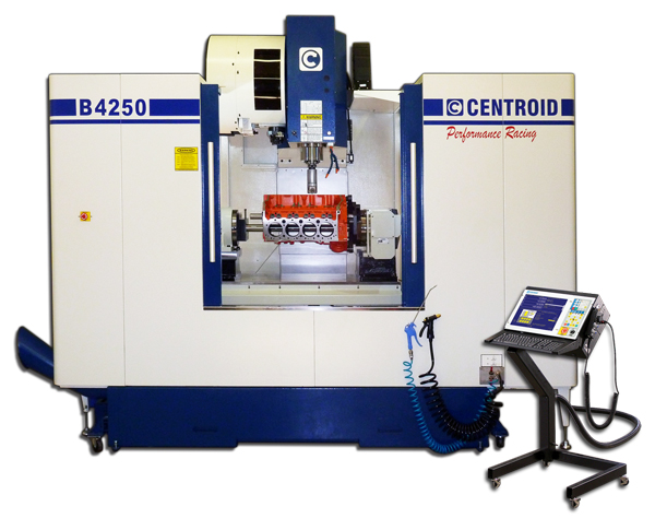

I can only assume the person who bored it out to .030 before had a machine somewhat like below. Didn't program it quite right,mount the block correctly, or whatever. So the latest person who bored it .040 hopefully straightened it out. It's the only thing I can think of that all 4 cylinders and their pistons have in common. I am also curious to know Orich's and Hio's thoughts, but also Bobby's,351's,and Tro's.
