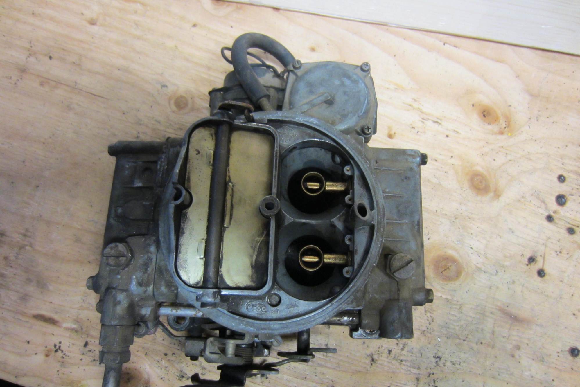

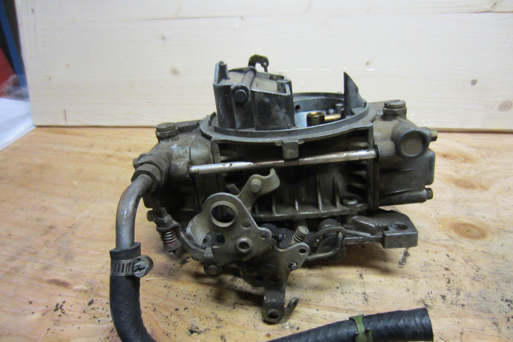

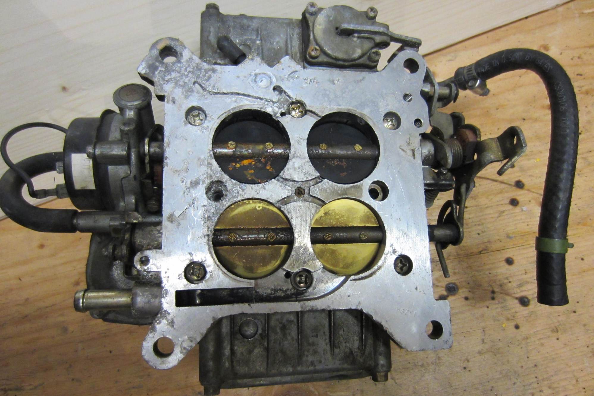

What kind of Holley 4bbl carb is this? Came off my 400 and needs a rebuild.... (posting here because more people read this forum).

I have a holly 750 double pump but yours looks a little smaller.. maybe a 650?

That is a Holley 4150/4160 carb. There should be a part # starting with a C or D that would narrow it down to a rebuild kit.

Look on the choke air horn for the list number [front top] its a model 4160 , but the list # will tell all you will need to know . I will look it up in my Holley book for you.
