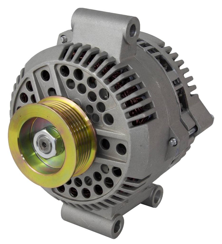

The 130A is 144mm in diameter and has two holes between the three sets of ribs on the front. (as pictured)
Your 95A is 135mm in diameter and has four holes between the ribs.

Look at the front of the alternator.
You will see 3 pairs of ribs.
If there are four holes between the ribs it is a 95A
If there are two holes between the pairs of ribs it is 130A
thanks! that sure will help!
