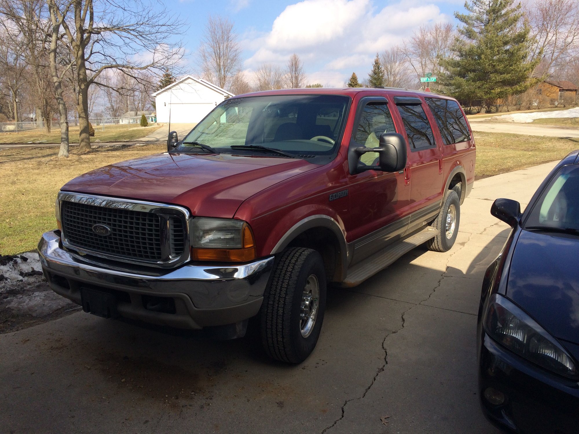

2000 excursion vibration
I have recently developed a vibration between 30-45mph only when coasting. It smooths out when I tap the gas. The tires are less than a year old and I just put new manual lock out hubs hoping that would correct the issue, but it didn't. There's no clunk noise when in reverse or drive but occasionally when I get on the gas there's a short squeaking noise. Can anyone help?
