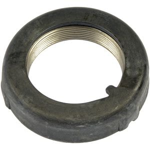

Here are the hub nuts.
Here's the procedure;
Install the hub nut on the spindle. Make sure that the nut tab is located in the keyway prior to thread engagement. Turn the hub nut onto the threads as far as you can by hand, noting the thread direction.
Install the hub wrench tool and tighten the nut to 55-65 ft. lbs. Rotate the hub occasionally during nut tightening.
Ratchet the nut back 5 teeth. Make sure that you hear 5 clicks!
Make sure the tang that fits in the keyway is not broke off. If it is, or your nut doesn't click when you back it off, then you will need new nuts. Autozone has them, part number 615-134. They come as a set of two for $80.
Yep, I hear no clicks when backing them off for the first time...and neither one of them had the key way tab..

That's your problem. The whole thing is spinning without the little tab. Grab the od with your hand to hold it, and then take the socket and try to back off the center portion. It should try to stop you, or you should feel it clicking. Your whole nut is turning, there is nothing holding it without the keyway tab.
