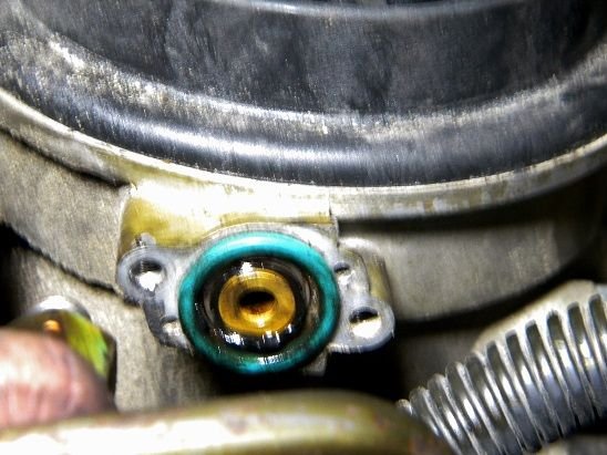

Originally Posted by Powerstoke73
Where is the fuel pressure regulator and is it possible the fuel pump could be weak
Here is the fuel pressure regulator/relief. The tapered oring was buggered on my bowl sending most of my fuel back to the tank instead of to the heads.
I was seeing 30-ish lbs at idle and about 5psi at WOT.
Believe it or not the truck seen to run great. Just didn't have much giddy up.
