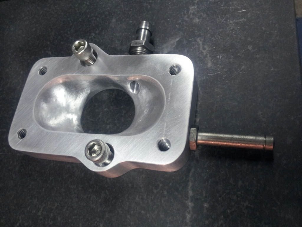

Here's an adapter I designed to adapt to a weber, which is what I have on my 200 ci power Falcon.
Mock-up before cutting and milling.
Finished adapter
Weber installed.
