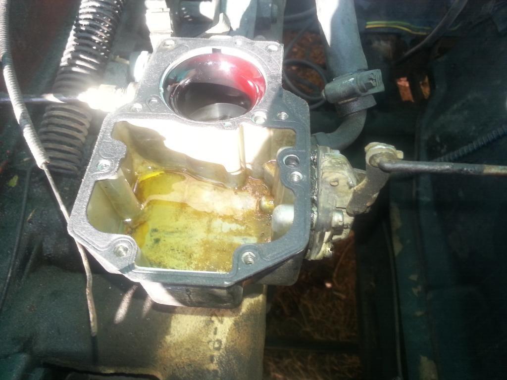

Finally got around to messing with my carb due to a gas leak. Didnt seem to bad. Believe its an autolite 1100. Watched a quick online video and used the $30 kit I picked up online. Gasket actually looked pretty good, so may been done not to long ago. I cleaned it up and changed gaskets, replaced a couple things. Wasnt as bad as id thought it may be.
So heres my deal as right now:
1:What is this rod and does it and the arm its attatched to actually do anything?
2: You can see where it was leaking down.
- Un marked arrows are where I suspect the leaks to have been. Alot of the moist is oil from taking off the oil bath air cleaner.
I finished it up and reinstalled but stripped where the fuel line goes in to the carb. I think the strip is inside the thread in the carb. Can I use a tap to rethread? Will I have to go slightly bigger and get a bigger connector on the fuel line? I assume Id have to be awful careful about any metal shavings not getting in the carb. Any suggestions.

The fuel inlet should have had another fitting in between the carb and your fuel line. It should have been 1/8" pipe to an inverted fitting. The first picture is a vent opening rod and lever that was later plugged. From the amount of fuel on top I would suspect your carb was flooding, check the float for fuel in it. The fuel pump maybe bad and leaking pay the diaphragm.

If the fuel is coming out the overflow tube that goes into the bore of the carb its flooding. The needle is failing to seat because of misadjustment, damaged needle, or to much pressure coming from the pump. Another issue is placement of the steel ***** in the carb.
