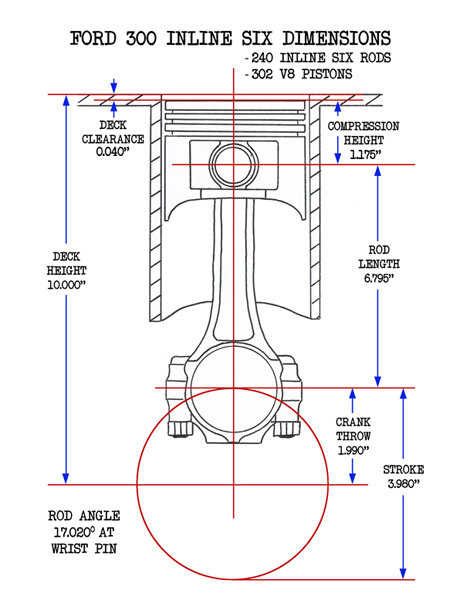

I'm using 240 rods in mine. The 11938's compression height is 1.175", which is too small for the longer 300 rods.

Originally Posted by bigfootsurfin
So what kind of deck height did you end up with using that setup?
Attachment 291081
