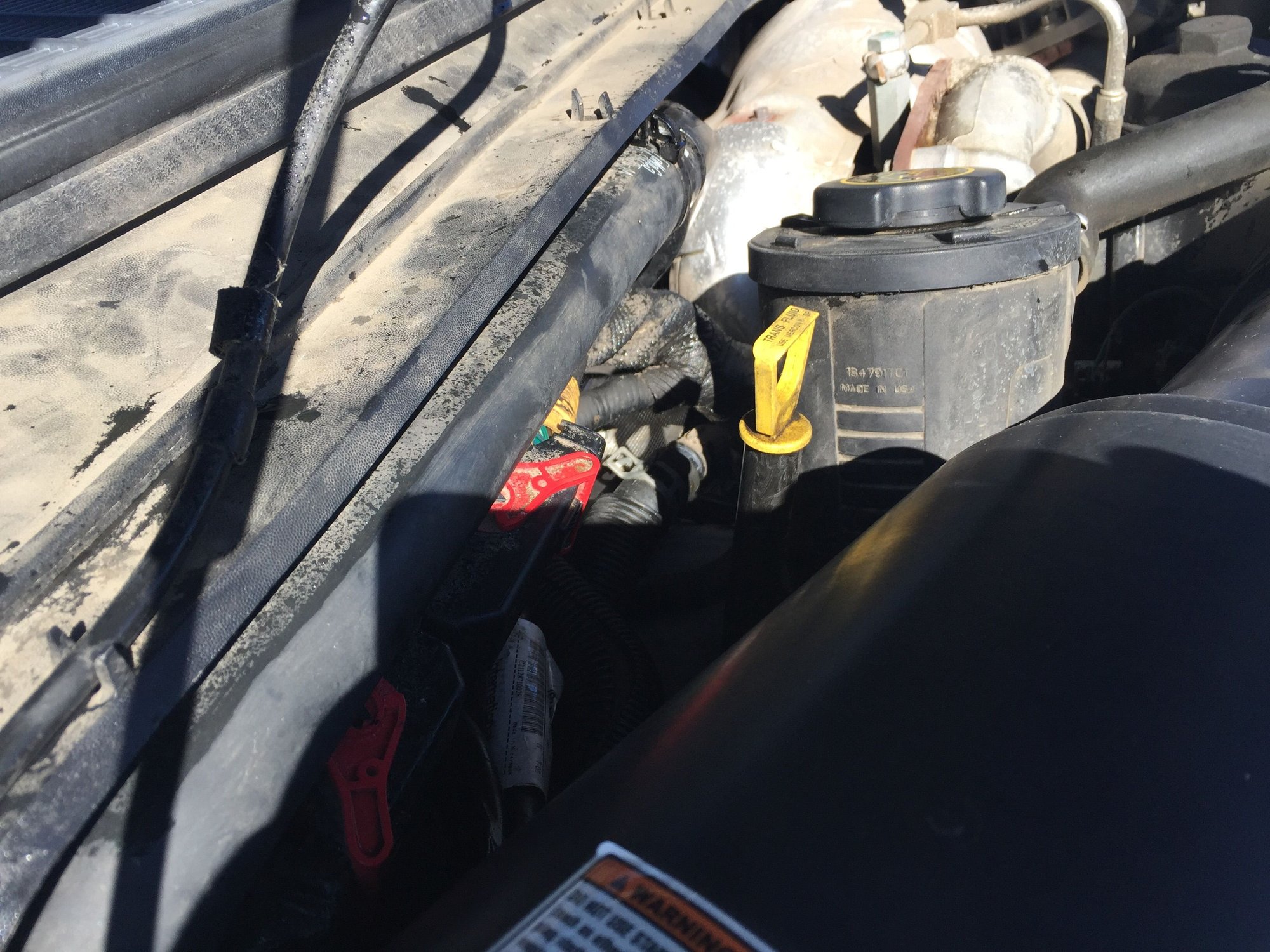

Coming down a hill my exhaust brake kicked in and rpm went to 4k for about a minute. Shortly after coolant got hot. Pulled over, hose that I think feeds the oil cooler had blown off. It's located too side passenger. Between the oil fill reservoir and the fire wall. Between the turbos and the wires to the computer. I'm stuck a a gas station that only has havoline universal. Can I just fill with that and make it home about 400 miles away?

Not exactly understanding. You are saying the oil filler ccv hose came off and dumped some oil?
Or are you saying you lost a radiator hose? Lost coolant?
If you lost coolant fill with distilled water. That should tide you over.
If you lost oil, let it sit a bit and short stick it to see the level. If in the hash marks still, then don't add a thing.

Coolant hose for the oil cooler blew off. Replaced it. Refilled with coolant. Back on road......thanks for looking

Only had access to distilled water. Just made it home last night. I assume first thing on the list is a complete coolant flush. Then oil change since I did see it reach 230 degrees. Anything else I should be looking at?
Then move on to why the coolant hose blew off the oil cooler? Any thoughts?

I would not bother to dump the oil either. I hit 230F coolant several times with my 6.4.
For the coolant hose perhaps the clamp is bad?
