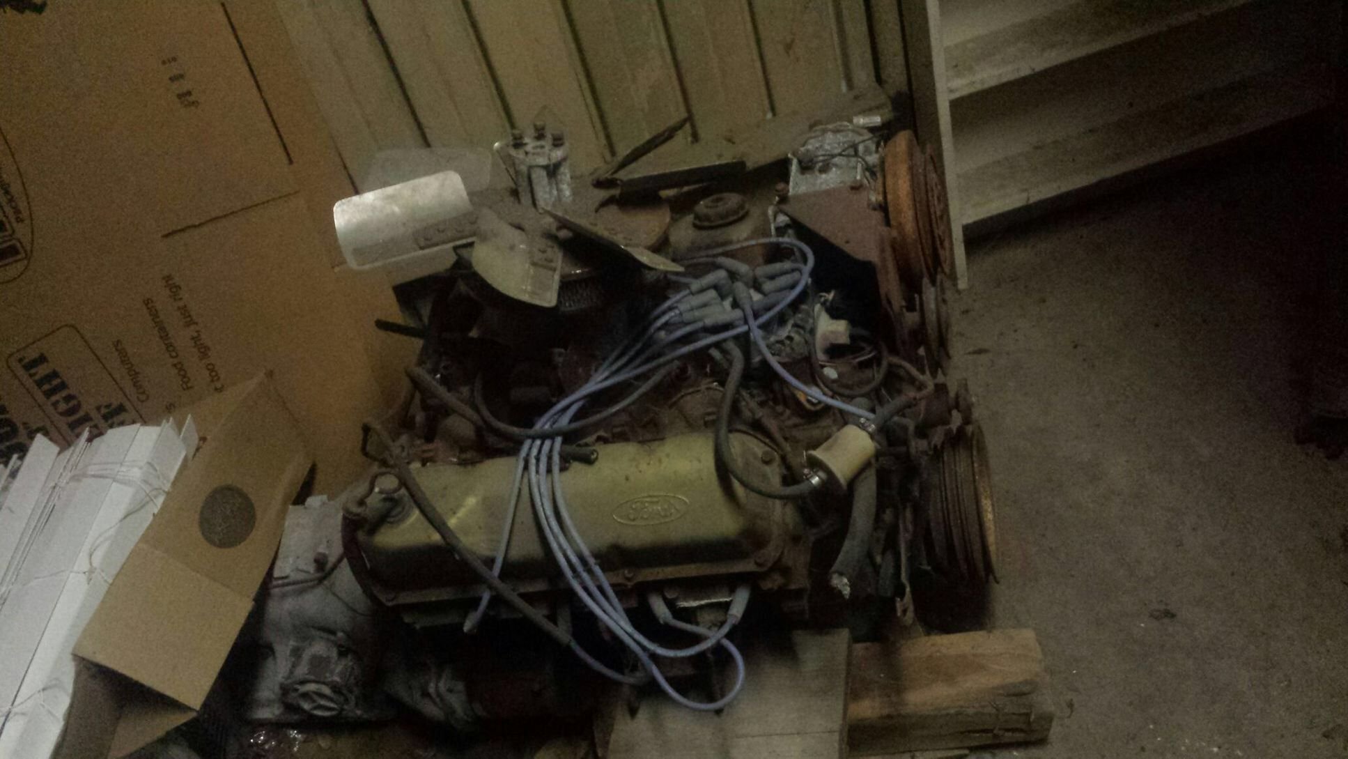

So I can buy a 351 c for $600 with c-4 trans for my 61 f-100 . Would it be worth it or just go with the 460 instead. The 351c came out of a ford truck and was running and has been stored inside a friends shop since it was removed.

I'd take a good look at that first. 351 C production halted in 1974 IIRC. Don't think they ever had Duraspark as that motor appears to have. That is more likely a 351M or 400. What year truck did it come out of?

No C was ever installed in a truck at the factory. Do some digging. There were 3-351s W, C, M.

Look at the bellhousing pattern, if its the same as a 460, its a 351m or 400. If its the same as a 302, then its a 351C.

T, The 351 C & M share a lot of the same characteristics as PRO shared, since it was pulled from a 70s truck, one would have to lean to the M. One quick way is to measure the width of the 2 top bolts of the bell. The C would be about 5 1/2" and the M 7 1/2" apart. Guys can get things mixed up after they had sat around for a while. Also I believe the paint is right for the M.

It is trivial to tell the difference between a 351C and 351M/400: the intake fits down to the block right behind the distributor. On the 351C, the "lip" on which the front of the intake sits is about 3/8" tall (up from the distributor mounting surface). On the 351M/400, that same "lip" is over 1" tall. It is simply a matter of looking behind the distributor to see if the lip is short or tall.
