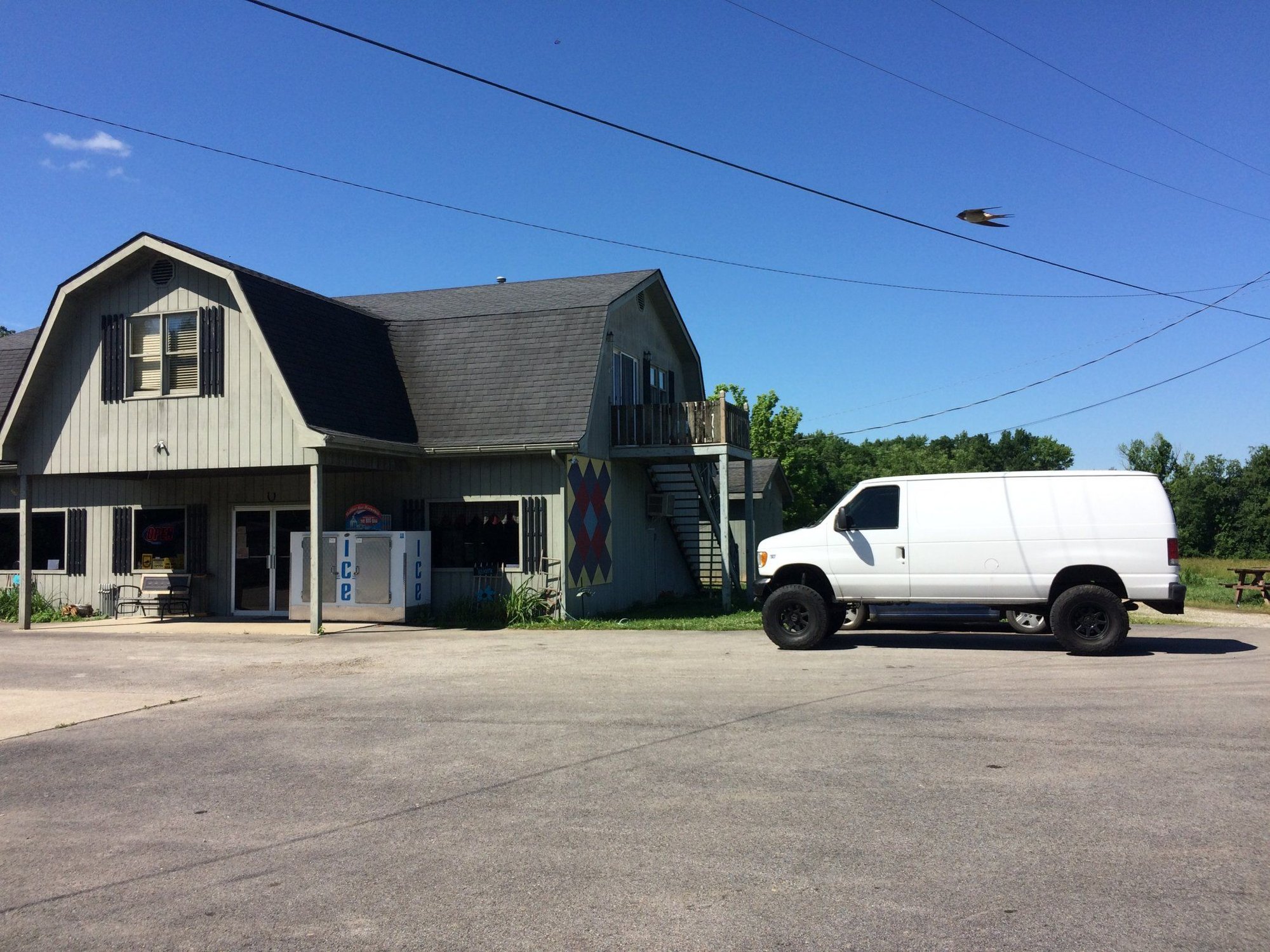

It turns out that my steering stabilizers were limiting my steering. I changed the center mounting point, moving each side out about 2 inches to allow for more travel in the stabilizer arms. Made a huge difference. I don't have to start planning turns a 1/4 mile in advance anymore...

Overall, I've been quite happy. The fab work could be cleaner, but I've pushed mine pretty hard a few times and haven't gotten anything to break. Axles and t-case on mine came from an 07 F350, so no issues there.
Complaints:
There are a lot of stuff on the exterior of mine that were powder coated. They aren't bad, but it seems like maybe it was a little thin, as I am seeing very light surface rust in some of the nooks and crannys. The steering was lousy, but I finally am happy, after replacing the gear box, and moving the steering stabilizers. Crows mounted them with the arms extended too far, which limited the steering at full lock. Would I buy it again? Yes. However, if money is less of an object, there are companies that do better fabrication work. Good luck!
