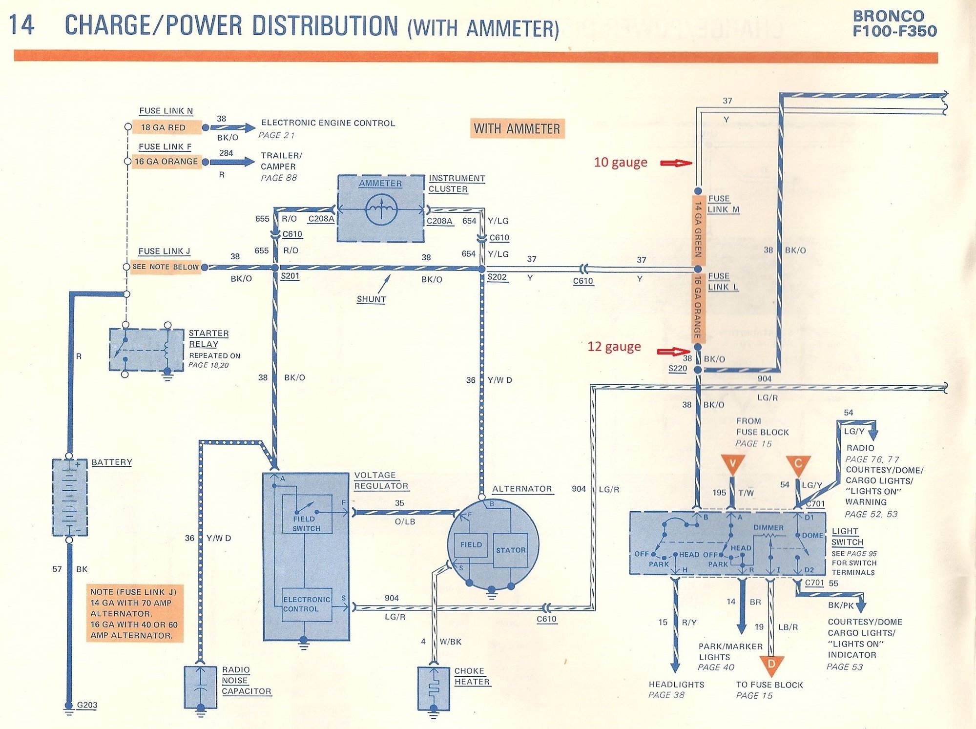

All of those with idiot lights do, but those with ammeter don't, as shown below:

I'm lost, Jim. His cluster surely has the resistor.
